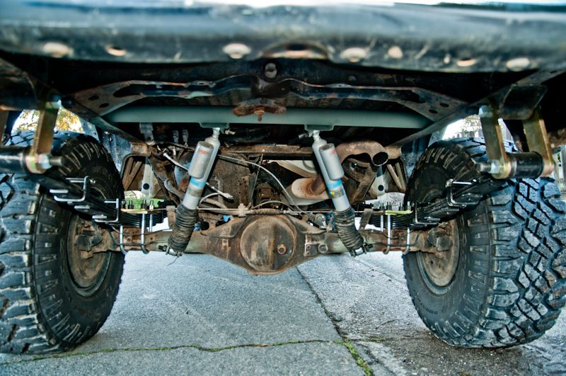

    Jerry relocated his rear shocks like that. The rear isn't really mid travel. Ill be moving my shocks like that here soon as well.
    Mid travel has to do with the front more or less.
    You get new UCAs and extended travel coilovers, like 2.5x8s. This combination gives you about 1'' more up travel and about 2-3'' more down travel over stock.
    LT is replacing the UCA, LCA and usually a 2.5x10'' shock. You can get has high as 14'' of wheel travel with LT depending on the kit.
