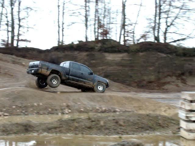

    Me too if any of you need a hand down this way. I also have a portable Nitrogen tank with fill adapter if anyone needs a recharge, and I'm pretty good at tuning shim stacks as well.
    Travel: doesn't mean squat. A well tuned shock and balanced car is far faster than lots of unchecked travel. That said, with icons and tc ucas I got 11", I'm sure of it. I measured from the holes in my inner fenders the Uca bolt made to the Uca bolt at full droop. That said, static and dynamic travel are different #'s. Shock towers flex a lot. Example: it's hard to simulate full stuff in a shop-
