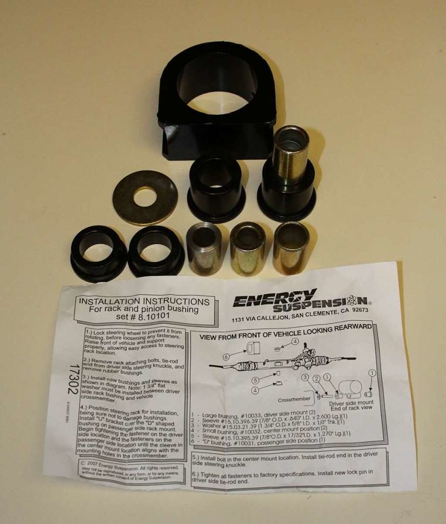

    FWIW,I got my kit at Wheelers Offroad. It looks like I might have paid a couple of extra $$ but it was for piece of mind.
    Wheelers adds 2 additional "short" sleeves to their kits, each extra sleeve has a slightly different ID because some of our trucks require it. You only use 1 the 3 but only 1 of the 3 will fit correctly.
    Here is a pic of what came in my kit.

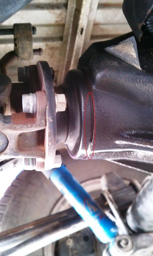

    Where is the leak on your diff? Is it coming from where the drive shaft comes in?
    edit: like in this pic?

    Hmm... 2 of the 3 mounts for the skid are studs, though the studs may thread in. The 3rd is a bolt. If it is from one of these 3 points, there are no "seals" involved and might be a simple fix with a dab of RTV.
    Have you taken the skid back off to see where it is actually coming from?

    After seeing this ^^^ picture, it is obvious this VVV statement is incorrect.
    Where ever that stain is coming from, it is unrelated to the skid or the actuator. In fact, that stain doesn'tlook fresh at all. If it was dripping onto the street today, it would still be shiny on there. Something isn't adding up.

    You need to pinpoint the source. Its definately not the skid or the actuator. There is a seal right there but that would not explain why it is coming down from above. Maybe jiffylube put too much fluid in it? Is it coming out of the diff breather?
