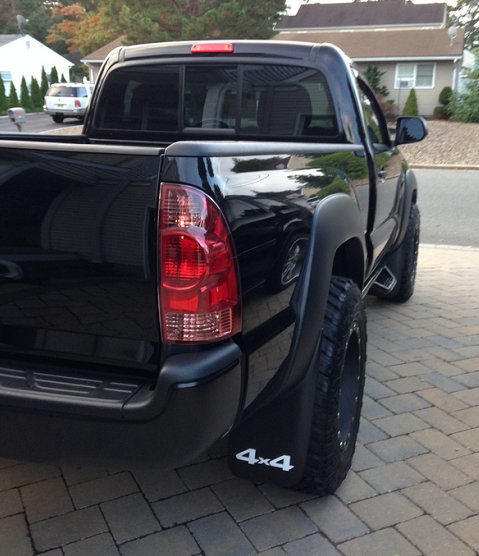

    Hey guys.. I want to keep on my stock mudflaps, but it bothers me that they have the White "4x4" on them.. i mean, i like the 4x4, but i was curious if anybody has spraybombed them with plastidip or anything, (and if so, how durable).. i just want to get rid of the white..
    i contemplated trying to paint them black with a paint pen, or use GoofOff to remove the white paint, but figured i would check here to see if anybody has OCD like me with these.. lol

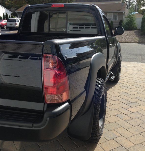

    I removed the white from mine. I used white wall tire cleaner (pretty corrosive stuff) an a stiff bristled, white wall cleaning brush and brushed away, the white chunked off like paint. I'll look for pictures and post what i find in an edit.
    Also, i didn't want huskys or weathertechs because they are so much more stiff than stock.

    Picture up friend! (I don't know how to attach them properly from my ipod touch) Took a while to find one that didn't have mud all over the bottom hehe
