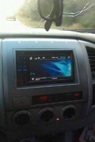

    i have a pioneer double din, and If i can any way put music onto something with a usb imput wire, it will play it. I bought a 16gig usb thumb drive that has all my music on and i just plug it into there and play it. but i usually listen to slacker radio on my phone.. Im sure it just depends on what head unit your using..
    here is a picture of mine in my xrunner
