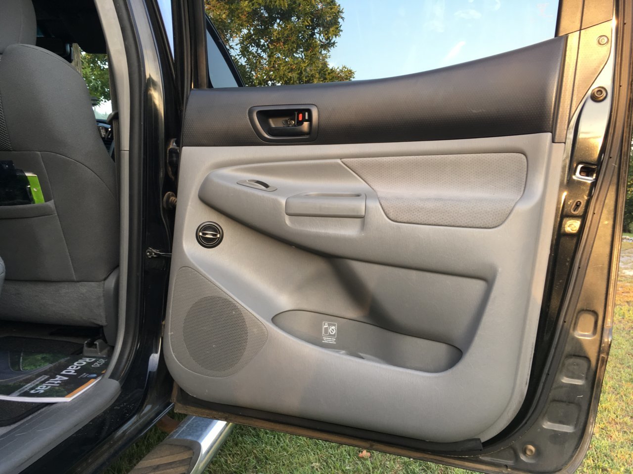

  10. Feb 6, 2023 at 6:50 PM
    dolbytone
    dolbytone Well-Known Member
    May 14, 2010
    #37165
    1,317
    South Carolina
    09 TRD Off Road
    Here is where I put mine.
    Taco 422 and soggyBottom[OP] like this.
