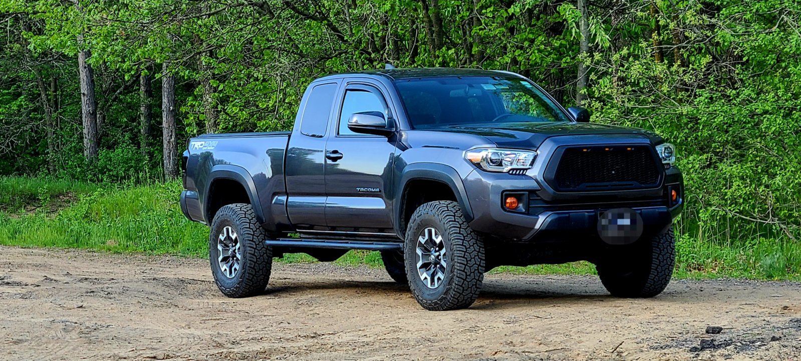

    2016 OR AC MGM
    2.5" front (settled at 2")
    1.5" rear
    265/75/16's w/ 1.25" wheel spacers

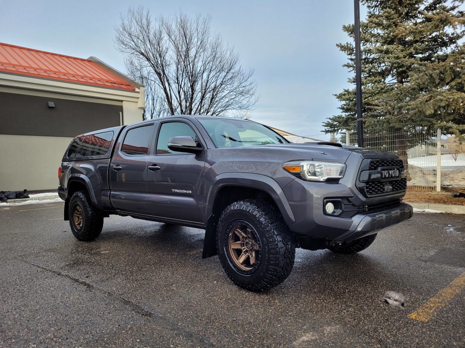

    2023 MGM Tacoma TRD Sport DCSB

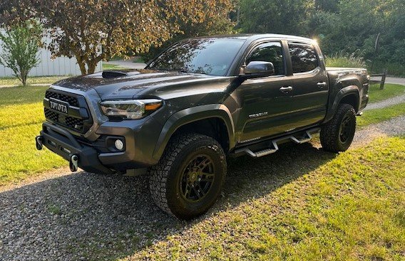

    Here are a few quick pics of my truck with 6112+5160+Icon RXT (option #1). As mentioned before, tires are 275/70/17 Falken Wildpeak A/T4W on FN f(x) wheels. I didn't measure my stock height, but right now ground to fender is about 38.5" at all wheels. 6112s in front are set at notch 11 (driver side) and 9 (passenger side). From the RXT specs, my rear should have been a bit higher than the front, but I have ~200+lbs of tools, etc., in the back which probably dropped it a bit. Planning to go to option #2 with the RXT leaf packs soon (i.e., replacing 3rd leaf with stiffer leaf included from Icon). That should give me back a little rake and help keep level when towing camper (along with weight-distributing hitch and SumoSprings).

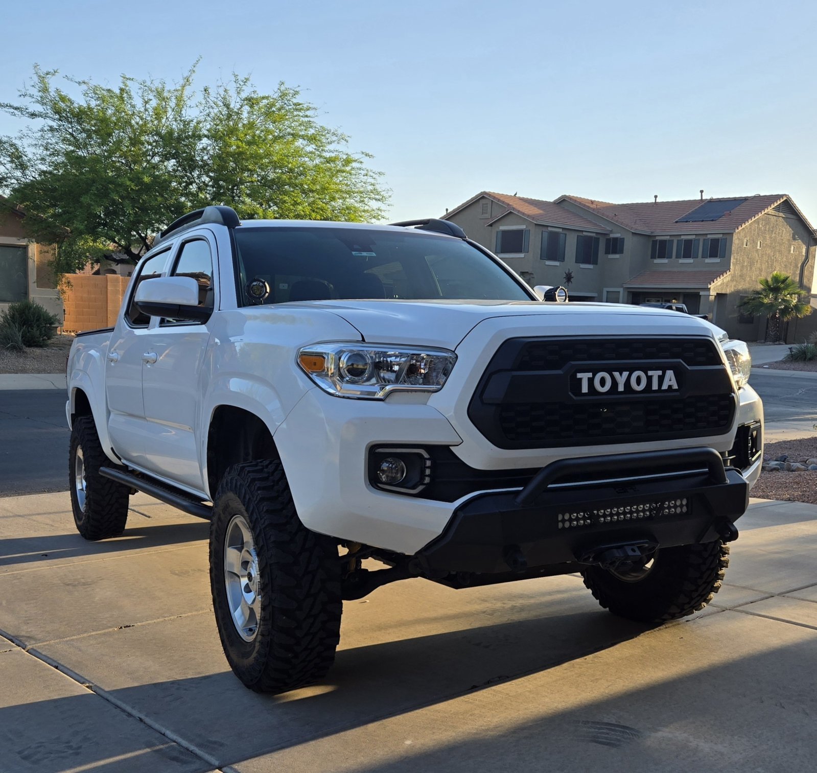

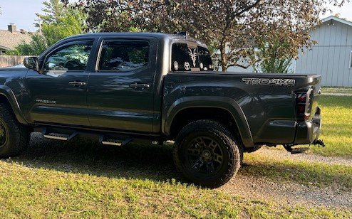

    2020 Super White SR DCSB
    OME 886 coils, Icon RXT leaf pack, Freedom Off Road UCA, nitrocharger shocks, 1.25" hubcentric wheel spacers. 265/75-16 Geolander MT's.

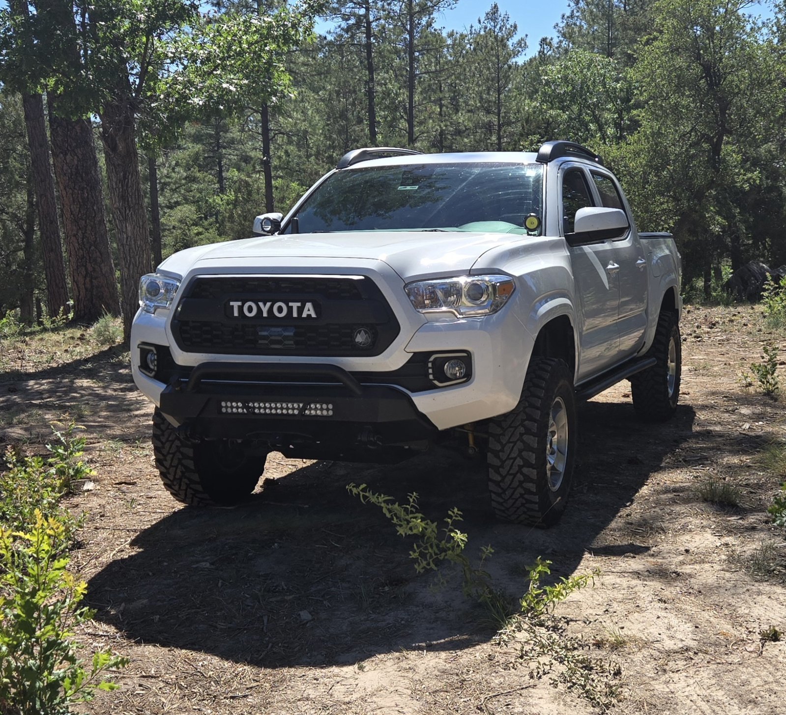

    Quicksand 2016 trd double cab off road
    OVT 1.03 Tacoma bed matt Husky floor liners Insain fab aluminum bumper with Baja design s8 30" light bar DB custums grill with Baja design s8 30" light bar
    Fox 2.5 front and rear
    Icon uca’s and rear springs on option 1
    Wildpeaks 265/75/16 on stock OR wheels
    Lift after settling is 2 1/2”

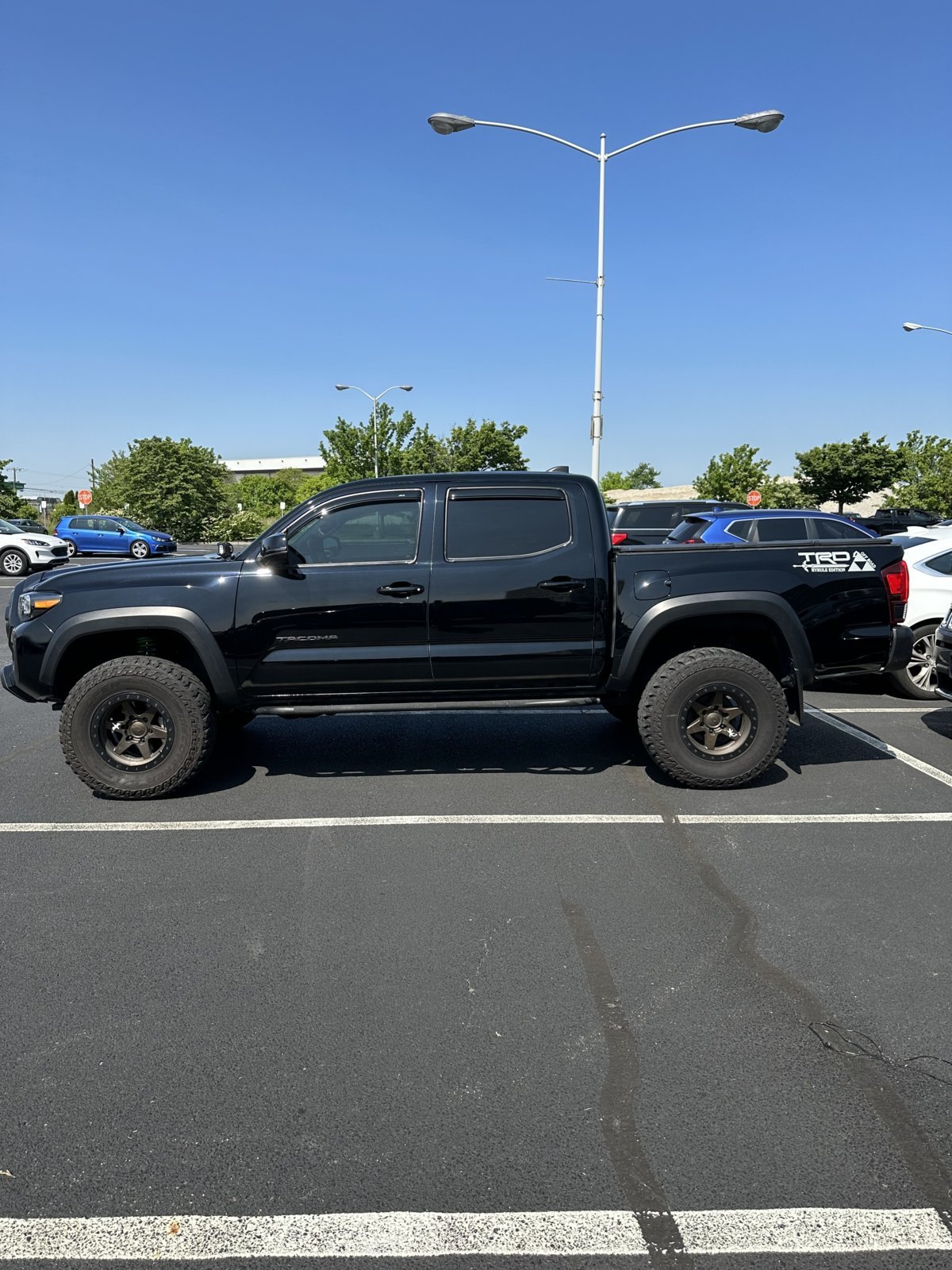

    Here’s two of mine, one with 255/85/16s and one stock OR tires, both with about 1.5/2” of lift

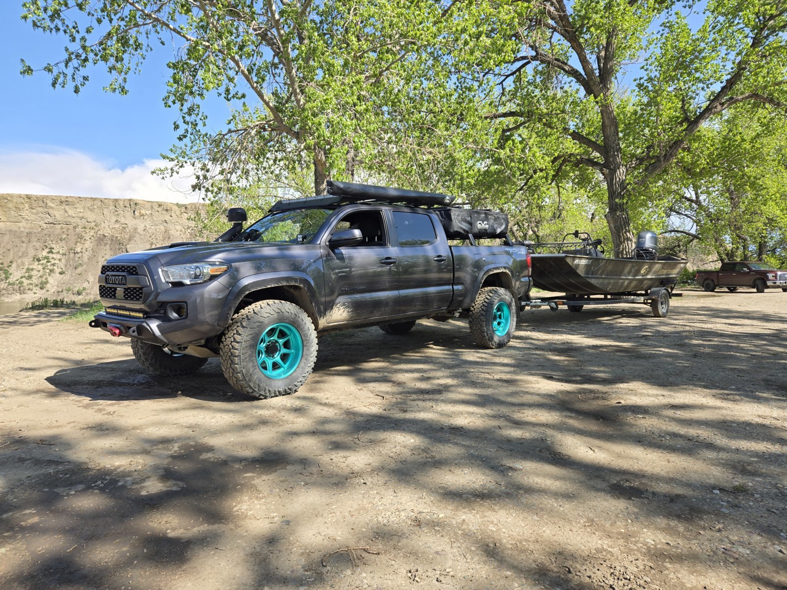

    I was getting that impression based on photos I've found. 265/75/16 would be okay-ish but id probably want to move up to 285s which is want to do a whole plethora of other changes.
    - 17" wheels + new tires (16" 285s are usually LT and would ride like a dump truck)
    - CMC or moderate trimming.
    - regear
    - needle bearing delete (plan to do this eventually anyway)
    I'll probably eventually get there but I have other mods higher on my priority list.

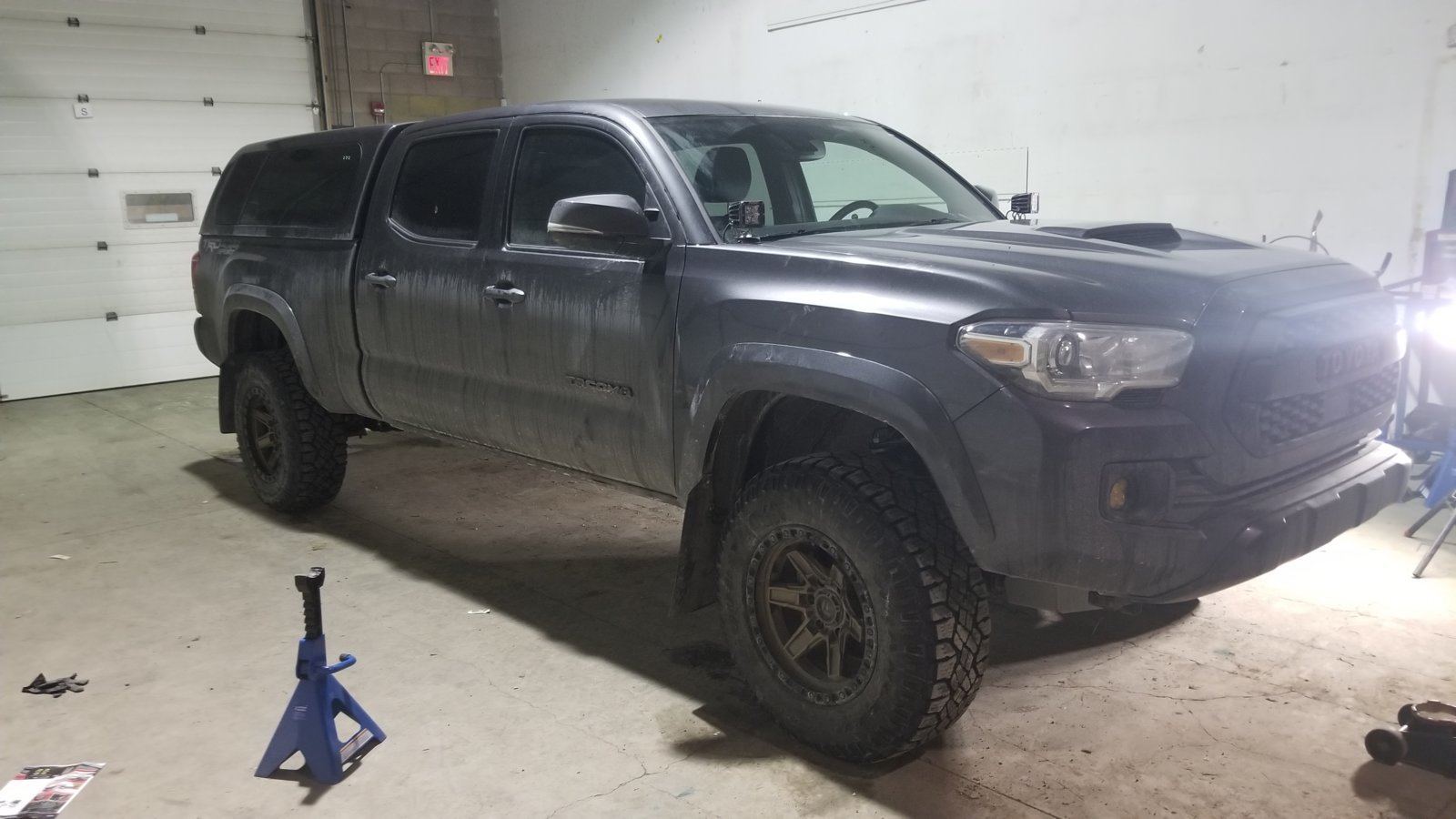

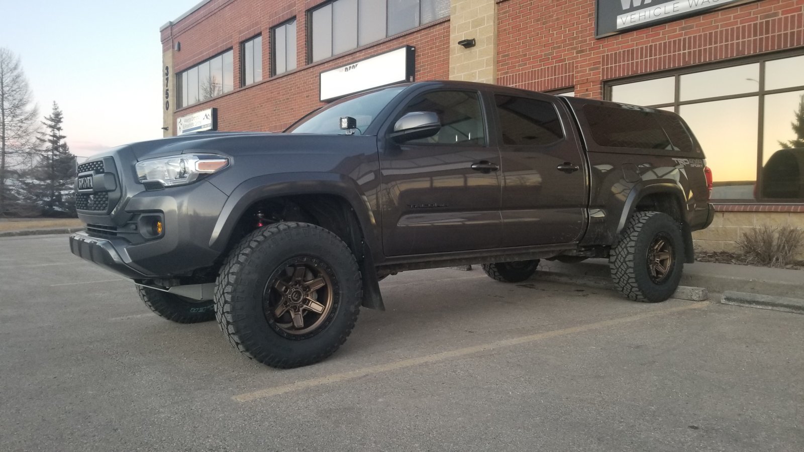

    Then I suggest sticking to little to no lift until your ready. But really to run a 285 on your wheel it's not as bad as your thinking. I ran and wheeled 285's with a 2" lift good alignment no cmc no re gear for a year till I bumped my offset and went to 295's then I just did the cmc and iv pushed my offset even further since then and I still have no real issues regarding the re gear and I tow somewhat regularly.
    Stock suspension 17x9 +1 265/70r17 duratrac
    2" front and rear lift some wheels and tires
    Some lift same wheels no chop 285/70r17 it would kiss the mud flaps on occasion when cranked and wheeling but never touched the cab mount.
    Spent a week on the road with the boat and the box full of gear still never really felt under powered and still managed 18L /100km over 1200km. Just saying it's not 100% necessary
