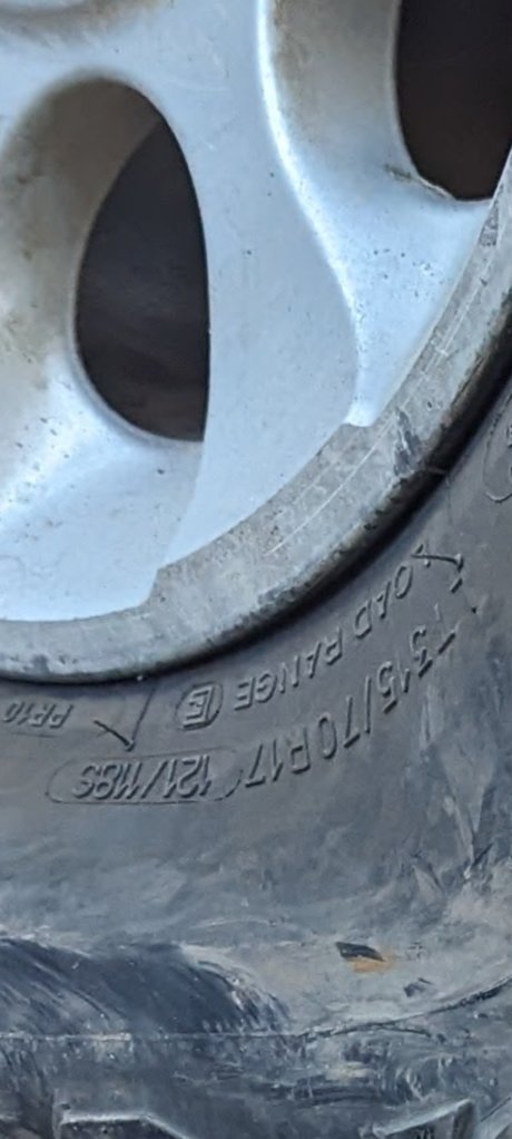

    Yes, they are LR E. as far as comfort my truck rides well but that in part is due to having really soft springs. I also don't run more than 30 psi ever lol
    dunno if the quality will hold up but you can see E right on the sidewall:D

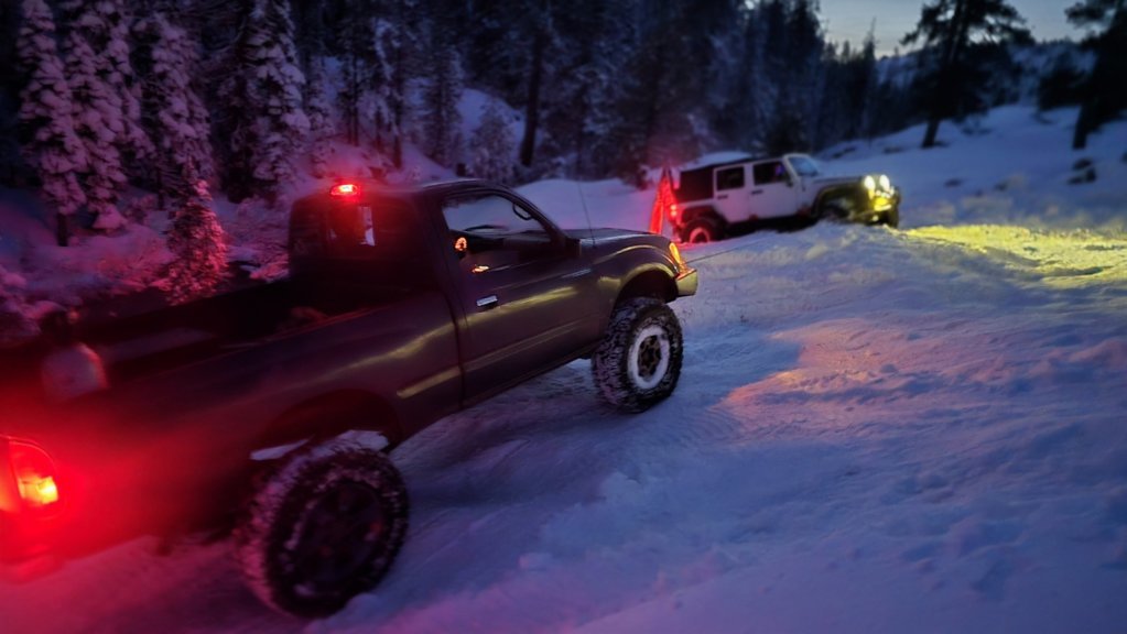

    I've always ran C, usually keep it at 8 psi in snow. Deep backwoods snow. E is way too stiff for these trucks. Even with C I run 29psi on the street. My tires wear evenly.
    Pic is near the spillway at the rubicon. Ko2 at 10 psi pulling a jeep out.

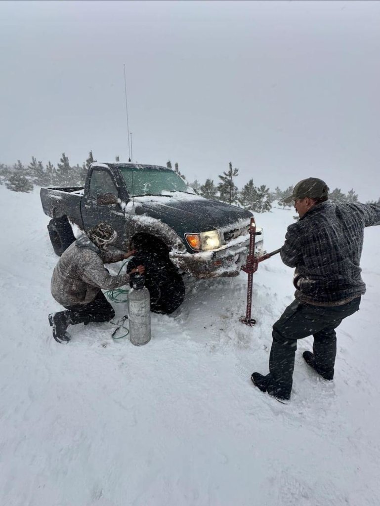

    I've lost a bead at 3 psi but it was a 10" wheel with km3. Starting fluid and a lighter, air up with co2 and you are good to go
