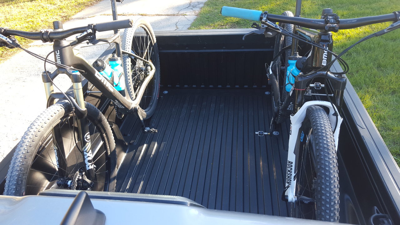

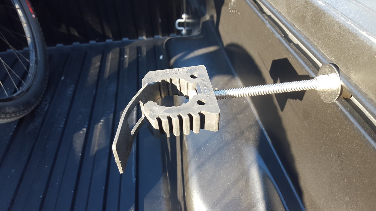

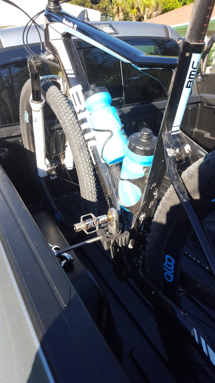

    I made this. I wanted the rack to be as small as possible, not have to remove the front wheel, fast to remove, and not get in the way of hauling stuff. I use an old heavy duty tube around the crank arm to protect it from the bolt head. This works great and is really simple. I have tried to get the bikes to move and cannot.

    You're a genius thanks for sharing

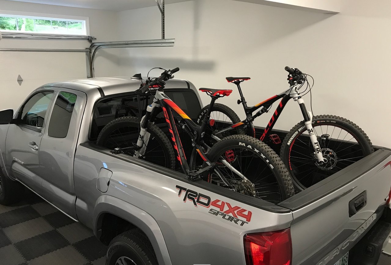

    Question for DA3 - Will the bikes be secure using just one mount on each side and securing the front tire with other means? I really like the bed being open between the bikes but the price is a little much for 2 kits.

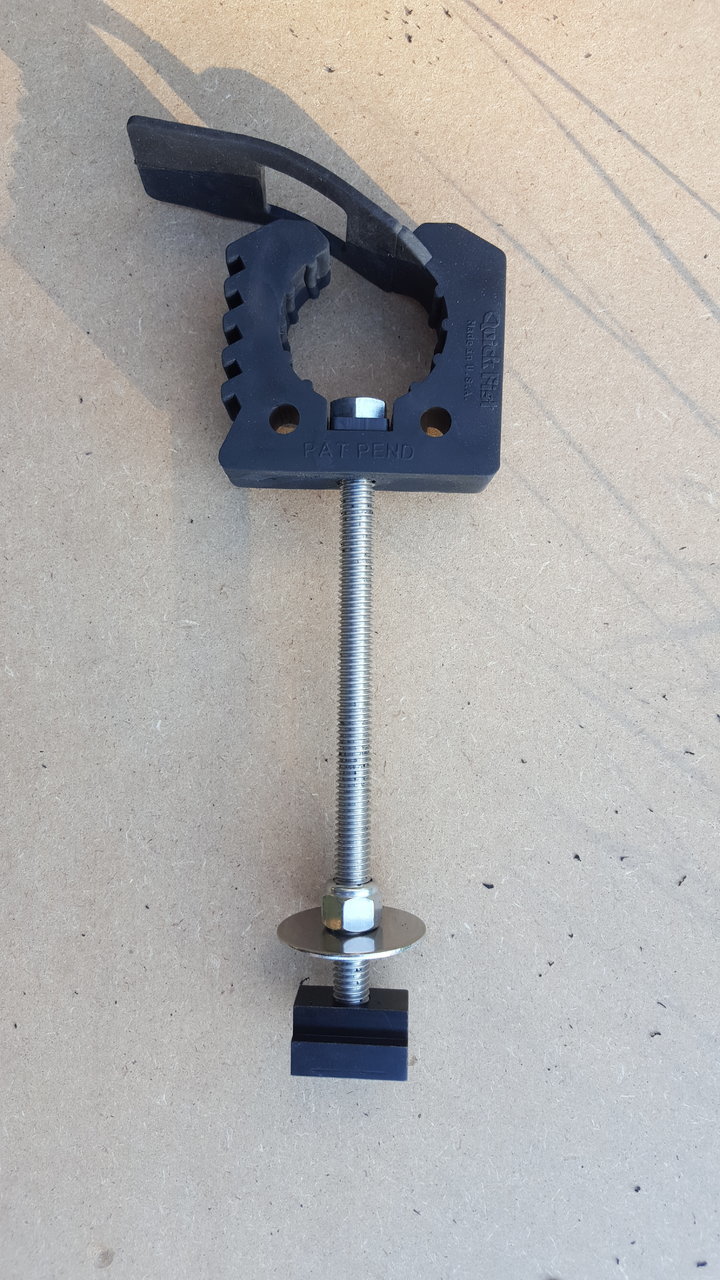

    The question I had for him is what did you use to secure your bikes with? I have never seen a strap like that before. Would a bike shop have something like that? I had the same idea with the threaded rod and bolting it to the side tracks but that rubber piece attached to the bikes is something I have not seen.

    Toyota Bed Rail Cleat T Slot Nuts, (4 Pack), Fits Tacoma & Tundra Bed Deck Rail Accessories & Tie Downs, Fits Screws with 3/8"-16 Thread. By Bolt Dropper https://www.amazon.com/dp/B073ZN63BH?ref=yo_pop_ma_swf
    Original Quick Fist Clamp for mounting tools & equipment 1" - 2-1/4" diameter (Pack of 2) https://www.amazon.com/dp/B000CQPANY?ref=yo_pop_ma_swf
    The rest was just some stainless hardware from the store.

    simple and to the point. I love it. Have you noticed any issues with the front wheel turning while driving?? Thanks for the info!!

    - They are super secure with 2 meaning they don't move a bit- I like the fact they can be adjusted (slide the clamp in rail to get the best fit) my bikes are large so I was happy with 2 each- but yes 1 would work. You can always get another set. (Pinnacle made the same thing) I like how the INNO attaches to the frame parts and INNO has the hoop on the end of mount to add a strap if you prefer- I removed all of the hoops as I only use this TACO as a rolling bike rack to bike trails. I'm the guy with 400 miles on my TACO and it's parked till June.

    How long is the bolt ?

    Yes, so it does slide into the rail and yes it has a metal part that rests on top of bed frame (literally not sure what that is for as nothing touches the bed frame) it's hand tightened into the rail - never thought about theft as much I park in garage and it wasn't a major expense to begin with. I personally like using 2 arms per bike - as you know the beds aren't deep and esp my bikes with larger tires- was thinking how big of a bump would send it out .. just a thought (I'd be more worried they steal a bike)

    Works fine at interstate speeds. The one above by @PinnacleChris would be more solid if you had rough going to a trail head or something.
