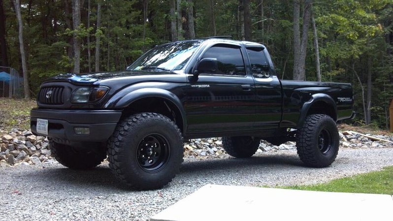

    What I do like is the corner lamps on this truck:
    https://www.tacomaworld.com/threads/2001-toyota-tacoma-sr5-trd-offroad.238015/
    I basically want to make the orange on the corner lamps be a bit darker, give it a bit of a shade or something of that sort. I don't want to make the headlights smoked, or to sand them or anything like that. Just want the orange / corner lamps altered. Not sure if I am explaining this right, but surely somebody gets what I am saying. Any cheap / easy ideas here? Could I somehow tape off the rest of the corner lamp (as I just do not like the reflector) around the orange reflector itself, and use some sort of spray to shade the orange down a bit? I don't want to completely ruin the function of the reflector, however.

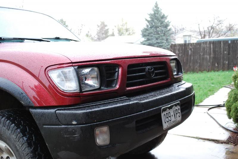

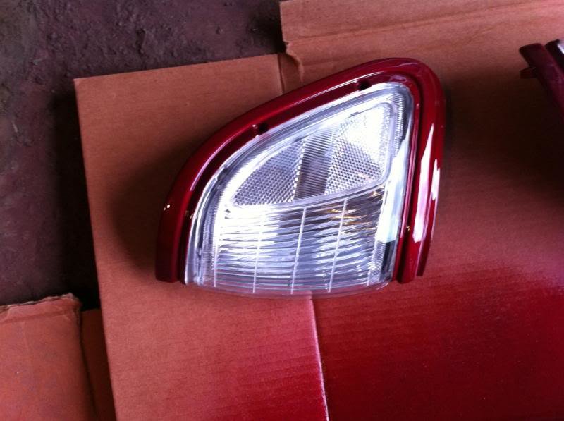

    Very easy to paint them. I color matched the clear corners to my Sunfire Red Pearl.
    Many places also sell lunar mist corner lights, but they have the orange lens portion.

    Yeah I found that about the marker lights with lunar mist border but I want clear corners. So do you just sand the chrome or black border off & put a coat of primer then a coat of lunar mist?
  11. Dec 3, 2015 at 8:00 PM
    Madjik_Man
    Madjik_Man The Rembrandt of Rattle Can
    Dec 2, 2009
    #26893
    19,706
    Colorado Front Range
    1998 Ext Cab 3.4 4x4 TRD 5MT, 2004 DC 3.4 4x4 TRD
    Yup.
    1. Put latex gloves on so that the oils from your hands/fingers don't get on the border of the lights.
    2. Sand the chrome down until it's uniformly dull. I use 320 grit, others say they need something more coarse.
    3. Wipe down with a prep wipe (I use the Duplicolor ones they sell at Autozone, OReillys, etc). It evaporates quickly.
    4. I do a few light coats of primer. Let it dry to tacky between coats.
    5. A few light coats of color. Lunar Mist can be found many places, luckily. If not I prefer to go to Sherwin Williams and have them put it in an aerosol can. Again, let it dry to tacky between coats.
    6. A few light coats of automotive clear coat. Sherwin Williams sells the two-part clear coat. It's tough as nails.
    7. Let dry.
    8. Enjoy.
