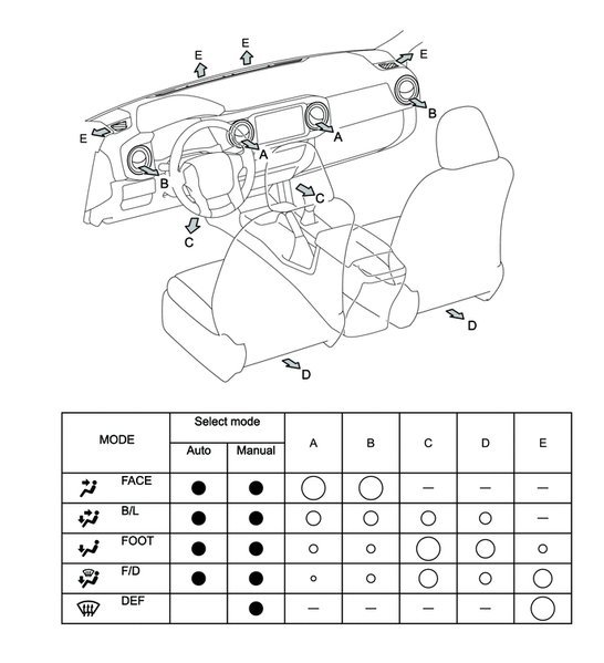

    You miss understood my initial question. I WANT outside air coming in, I just want it going to my defroster or floorboard vents only when selected with the dial. What I don't want (and what's happening) is when I have outside air coming in to my floorboards as indicated on my selector switch, the air is also coming forcefully out of the dash vents on the far left and far right side of the cabin. The two dash vents in the center are getting zero airflow which is how the two outside ones should be as well when floorboard ventilation only is selected.

    This is all there is:

    Perfect, so I have the defrost selected and I am getting a good amount of air flow through vent B at the same time. According to this chart there should be zero airflow coming out of vent B when defrost is selected.

    Not really what you said in your OP, but mmkay...
    @tonered nailed it with the pictogram...and like I said, working as designed :hattip:

    Yeah. If on the past Defrost setting, there should be no airflow at other places. It has to be fully clocked over though.

    Yeah, it's all the way over on the defrost setting and a fair amount of flow is coming out of vent B. This is why I figured something is wrong and was looking for a fix.

    That sounds like a trip to the dealer. I don't think any DIY will help. You could try a battery disconnect to reset all the systems? Remove both terminals from the battery (negative first) and touch them together to drain down the system. It had helped me with weird electrical issues in the past.

    Seems that if it's actually a part of the defrost then the chart that tonered posted should show a small circle on the B column under defrost.
