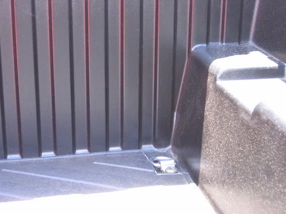

    You can add D-rings to the bed mounting bolts like this:

    That is a good idea. Thanks. I also bolted some to my anchored tool box with big 16ga fenderwashers to spread the load for a couple extra points.

    Yep, i didn't notice that; it should be pretty easy to add a couple D rings at the right height over the wheels. thanks:)
