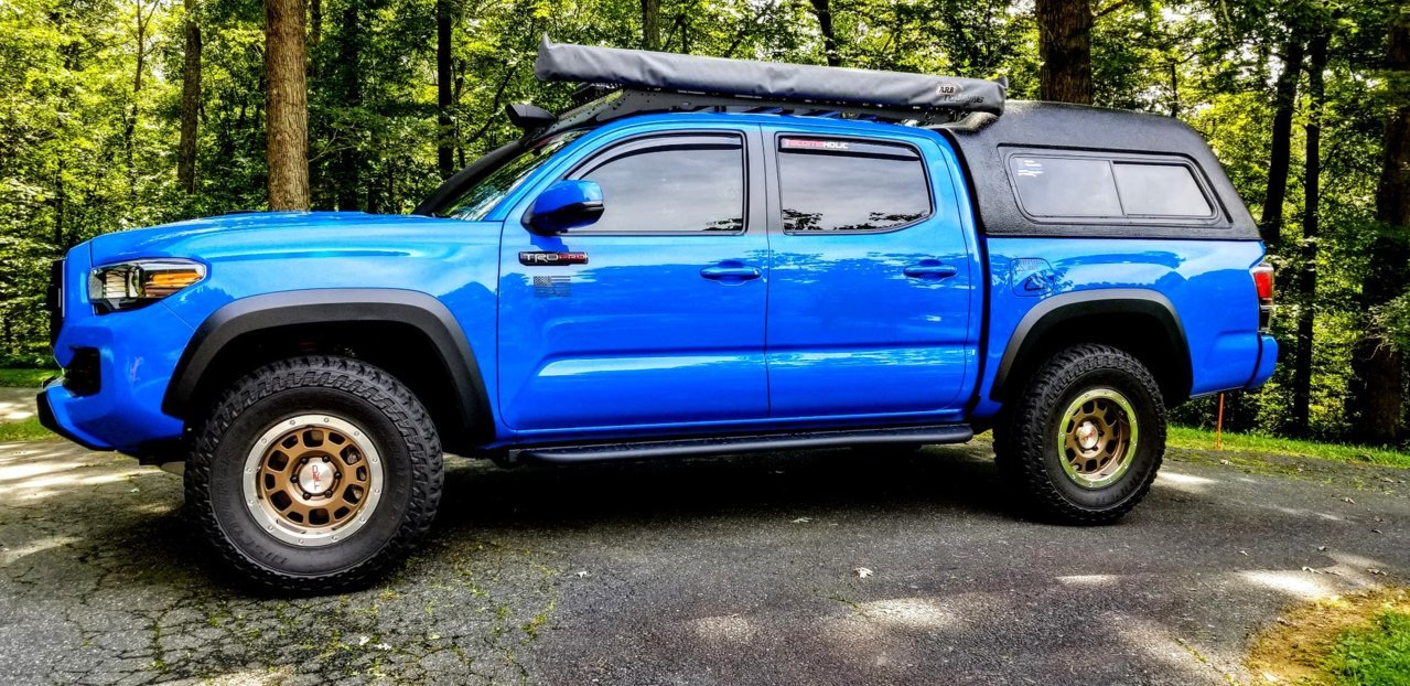

    Yea, I think anyone 6' or taller would have to go diagonal. I would highly recommend a mid/high rise cap too. The biggest complaint I hear, when people try to incorporate a platform is that a cab height cap feels like they are in a coffin. I only plan on sleeping in my bed in extreme weather conditions (mainly rain). I have a ARE MX, but Leer makes one, and so does Snugtop. If you're trying to save some money, get a used one and either paint it yourself (what I did) or have it color matched. So far mine has cost me 1/3 what a new one would cost. If you can opt for a new cap, definitely get one with windoors on the sides. That is my only regret about mine. Definitely get a carpeted cap. The fiberglass inside is not too harsh or raw but it is not that smooth either. Get a sliding front window if you have a slider in the cab of the truck. With an inflatable boot (essentially an air lock) between the cab and the cap, and the addition of a remote start mod, you can have the A/C or Heat on and cool off or warm up in a pinch.
    I had a cap on my Tundra and liked it a lot. I had a tonneau cover on my 17' Tacoma and it was nice. When I got the 19' Tacoma I put a softopper on. It looked very cool and is a very versatile option. Since I have a trailer I decided ultimately on a cap. A buddy on here bought one and had it LineX'd. I loved the look so I followed his lead. I bedlined mine myself though and saved a bunch of money. I think it looks great on the Pro.
    YgoTL_71Qg0-ipL0igxH3S45pYwqi8wsx2PYmNiM_bc7db1eedf5cbbc93a879ee68a71b2da6ff18450.jpg
    Tacman19 likes this.

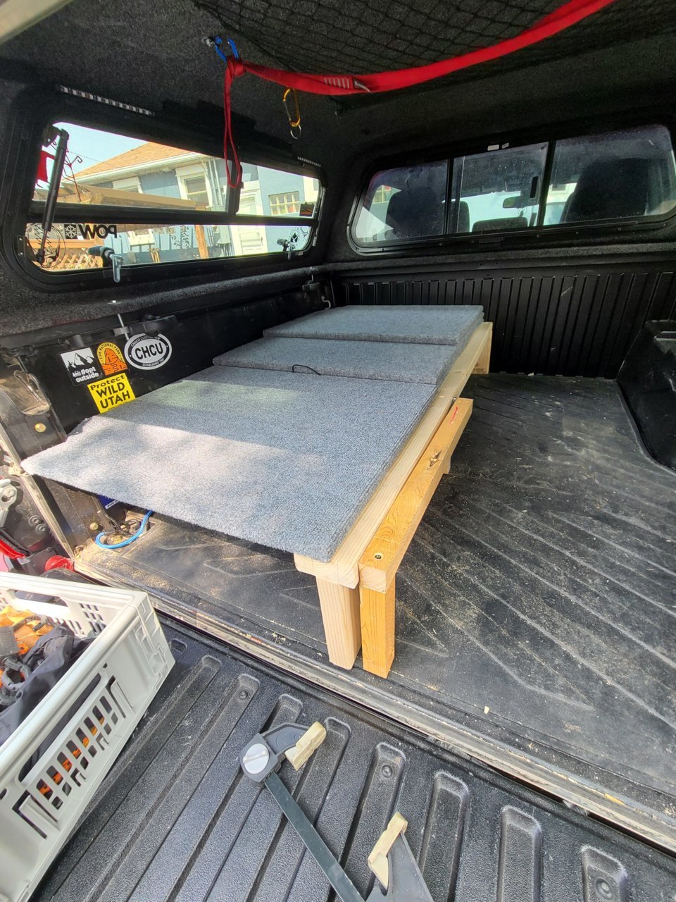

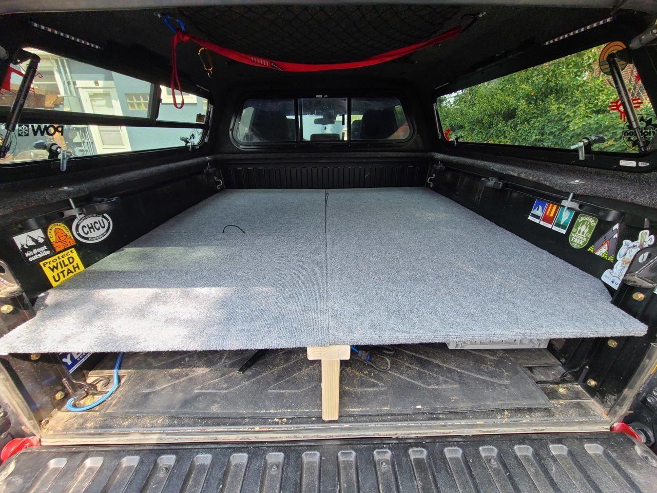

    Here's mine. I have a modular platform I built, with 4 carpeted plywood panels. I can sleep diagonally, and if my wife is with me, we put our Rubbermaid camping bins on the tailgate to use as support for our Exped MegaMat Duo camp pad, and just leave the tailgate down. In a pinch, we could both sleep in there with the tailgate up, as we are both fairly short.
    But solo, diagonally works perfect for me. 20200916_121754.jpg 20200916_121624.jpg

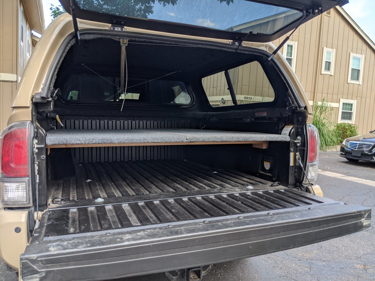

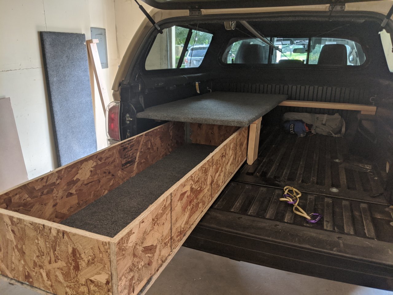

    Rooftop is the best, but depends on your budget. I just finished a similar build to High_Desert_Rex. I leave the half platform setup and drawer all the time, and then I add in the other half if I am camping.
    Then I also added a 3 fold 4" foam mattress so I can sleep diagonally. And then fold it up to get it out of the way.
    For warmer weather, I'm going to add a 1 ft extension and a bug net so I don't have to sleep diagonally.
    RobP62 and High_Desert_Rex like this.

    Nice drawer. I like that. I thought about building one, but just decided to keep it simple and light for now. My camping bins slide under nicely.
