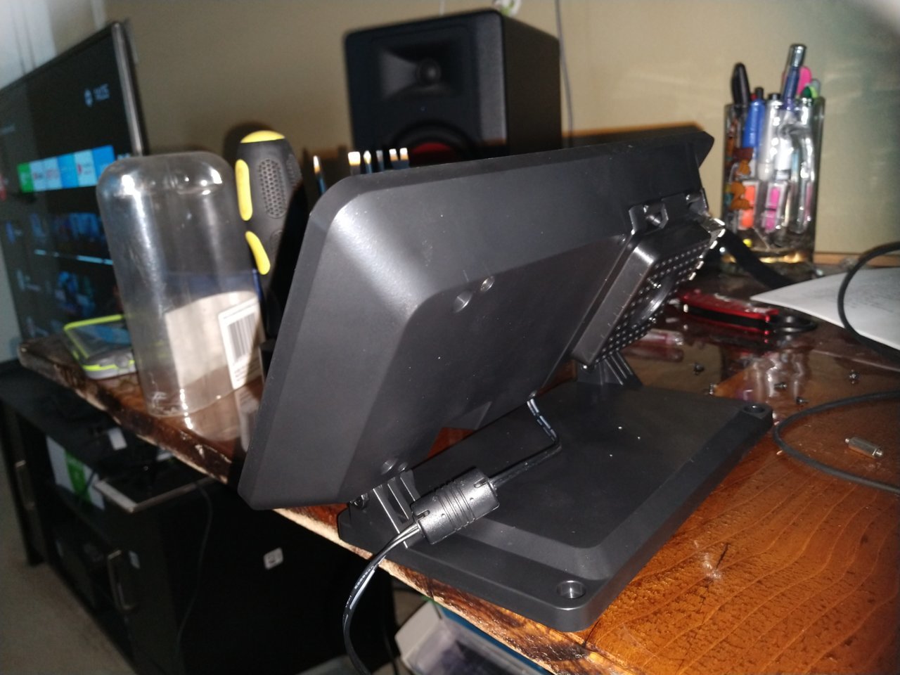

    But finally got the case in and can slowly start planning the install a little more now

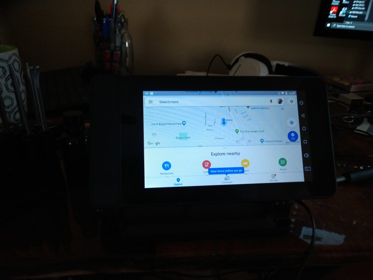

    Sorry its been a moment since I posted on here. I did a complete mock up and test without installing it. Issue I ran into with it is that the Tinkerboard did not like running for more then 20 minutes with Nav working. Think that was a over heating issue with the unit.
