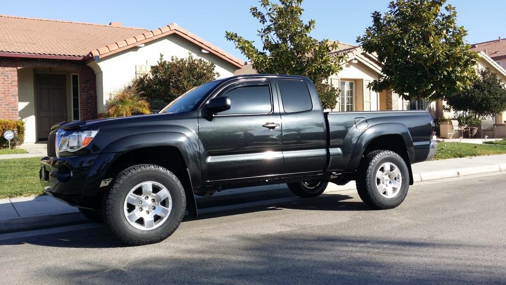

    I currently have 5100's set at the highest with the stock TRD off-road springs. I'm running 265/70/17 BFG Rugged-Terrain's on spidertraxx wheel spacers. I currently rub while turning and going into a driveway or hitting a bump. I hardly off-road and want just a little more lift to maybe be able to get 275/70/17's with the spidertraxx and no rubbing. I have a 4x4 but would like just a little more lift. Any inexpensive suggestions would be appreciated.

    Cab mount chop / determine where you are rubbing.
    You are going to need new UCA's

    The 1/4" Toytec spacers would give you about another 1/2". Without going to a drop bracket lift 3" is about max for 4x4's due to your CV axles being put at bad angle.

    put 885x coils up front and go with a sping pack in the back and you would have about 3 inches

    Your rubbing is due to the wheel spacers, not lift height. I don't see why that is hard for people to understand. You pushed the tires further away from the rotation point (ball joints), increasing the scrub radius. When you turn the wheel, the tire is moved further forward and back in the wheel well. Which is why the tires rub when turned and compressed.

    I'm thinking your idea of the 1/4" spacer is probably the most inexpensive. I can get them for both sides and I'll probably get some UCA's. Not sure if I need them but I like the way they look especially camburg and total chaos.

    When I was on 265/75/16 All-terrains I never rubbed, even while wheels are turned and I would go up a driveway hard. When I swithced to 265/70/17 Rugged-Terrains, I could pull in to a driveway at medium speed and I rub. From the tire size calculator, it says they are same size overall.

    I think I'll try the toytec 1/4 " spacer in front and maybe a 1 1/2" block in rear. I already have a rear 1" block would like to keep the same state I currently have. I think that's considered a body lift. Correct me if I'm wrong.
