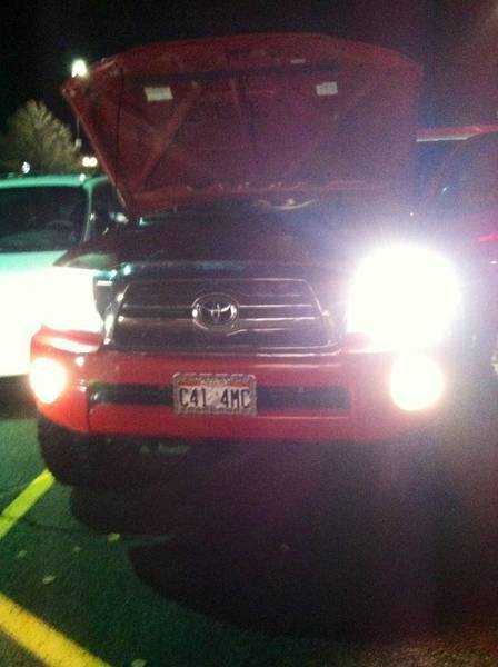

    2.5 inch pro comp lift Cobra XRS 9745 Detector 15 band scanner Pioneer DEH-P6900UB Python 991 remote start/ security. Tinted license plate covers Fog Light Mod PIAA Extreme White 4000K Replacement bulbs Red LED Dome and Map lights LED replacement tail light bulbs Black Weather Tech Floor Liners front and rear
    or get these :)
    PIAA Extreme White Plus Bulbs 65 bucks 1 year warranty. bright AF. dont even need high beams but the pic is with highs and fogs
