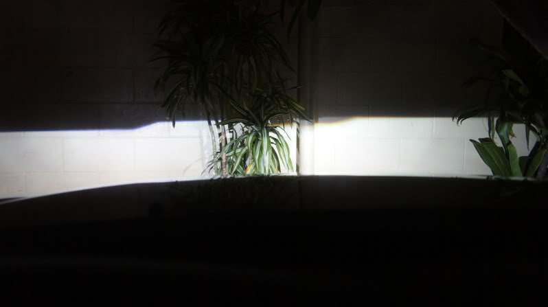

  17. Mar 23, 2013 at 9:44 AM
    #37
    mloco575
    mloco575 Well-Known Member
    Mar 14, 2013
    #99737
    111
    CT
    2011 TRD Sport DC long bed
    No the cut off on the left is nice and low... Almost too low but I think it'll be great once I get new bulbs. I'm thinking high end sylvania
