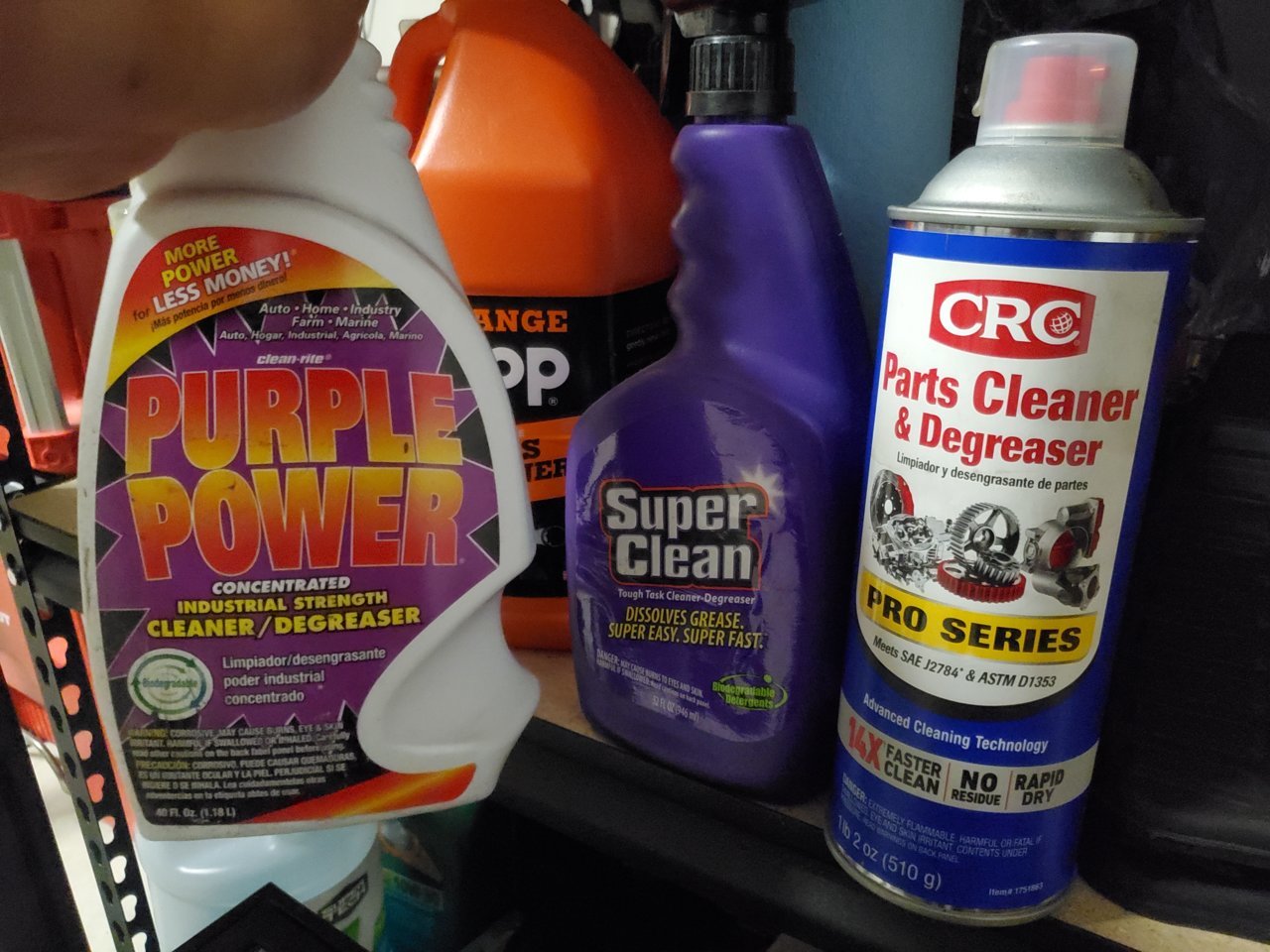

    Some of the degreasers and brake cleaner readily on my shelf -
    Simple green is in the kitchen under the sink since I use it for various items.
    Bags of rags and 12 pack of shop towels in the background -
