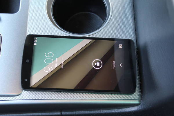

    I didn't wanna install it on my daily driver and be with a semi working phone :(
    So I just used the wallpaper. :cool:

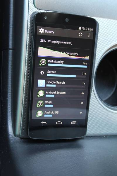

    I'm a little late to reply.. Just tried it with the official Nexus case and it works fine.
