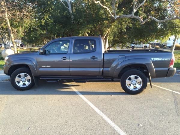

    Hey Guys,
    I recently became a Taco Owner and already my mind is racing on what to do to my truck. I plan on doing some southern california and AZ trails but do drive to school everyday so don't want anything that is going to hurt my mileage. I just wanted to hear your more experienced opinions on; how tall a lift to do without voiding warranty or messing mileage up, what brand to use for such lift, and any other suggestions.
    Info about my truck:
    2014 TRD Taco 4x4
    if you think the suspension that comes with this model is good already for a while then what else could I do to fit a bigger tire? Body lift any good?
    Im sorry this thread seems so scattered just want to ask as much as I can now so I don't bother you guys with a similar thread down the road. Thank you so much and I look forward to hearing all the wonderful ideas you have to offer.

    Biggest tire you can fit right now would be a 265/70/17. Any time you lift and get bigger tires your mileage will suffer to some degree. Any price range you're looking at? You could go with Bilstein/OME if you're on a budget or Kings/Icon/Fox if price isn't and issue.
    I'd stay away from body lifts.

    Might be a little biased, but I would go full OME and 265 as you are concerned about mileage.

    Bilstein 5100s, General HD Leafs, and OME 884 coils will get you about 2" all around on a DCLB for ~$1000. Not too bad for all new all around (no AALs) while avoiding pre-loading coils IMO. Also, it'll align fine with those changes.
    http://www.tacomaworld.com/forum/suspension/357147-general-90-297hd-4-leaf-packs.html
    I think I'm the first to do that exact combination here, but I'm very happy with it. IMO, it's what the truck should have been stock. Rides better, handles a load much better, and sits a bit higher. My mileage has stayed the same, but I'm also still running the stock tire size.

    hey js312,
    That sounds about the way Ive wanted to lean toward. I was planning on going 1.5-2 inch lift and had an idea about new coilovers , rear strut, and leaf pack. thanks for the input! Any pictures you wouldn't mind sharing?
