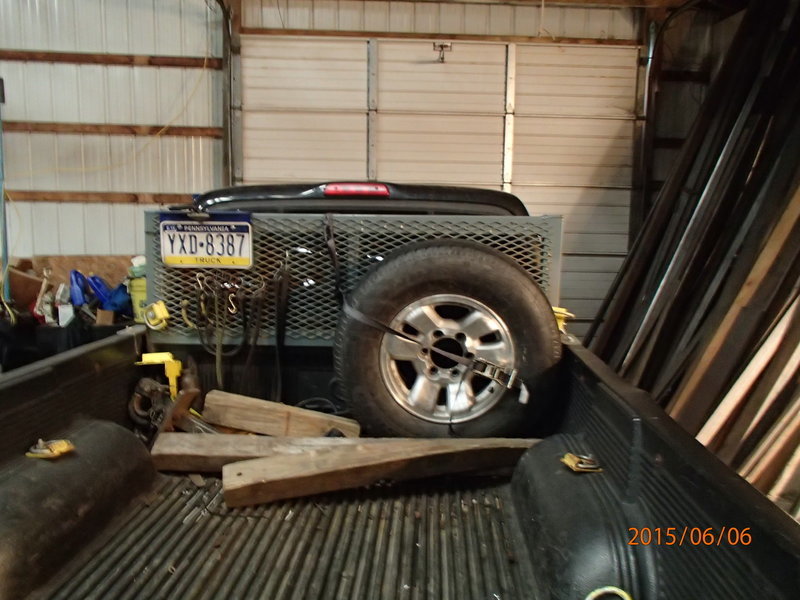

    I thought long and hard where to put mine.
    I could have built anything I wanted
    Having to swing things out from the tail gate would have caused more hassles .
    I just attached it to the rack that protects the rear window been a few years now it works great for what I need

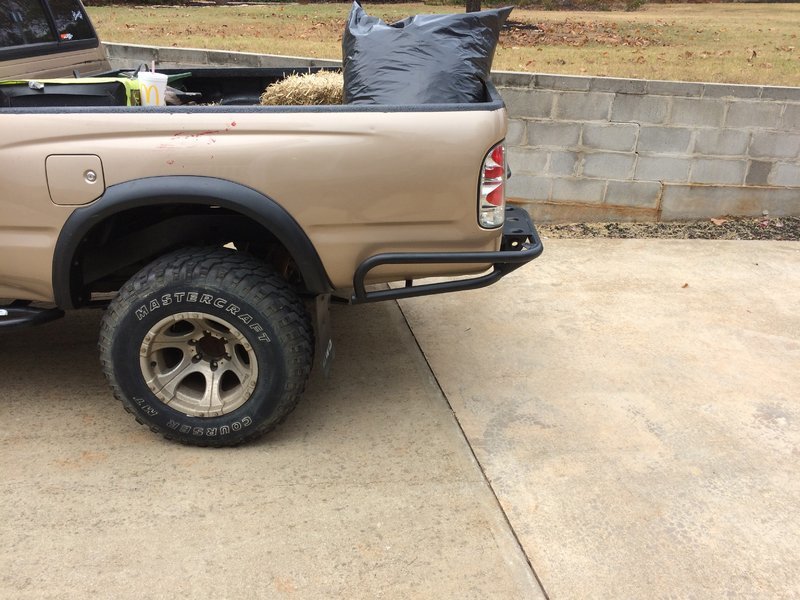

    I personally would not install a tire mount/rack fitted to the All-Pro or any other rear bumper
    unless the rear section of the frame rails where boxed or at least plated in support.
    The rear portion of the 1st gen Tacoma frame rail(s) will likely sag over time anyways...
    even without that extra weight added behind the tail gate.
    I place my spare in the bed on a fabtech tri-mount.
    But it could be fitted under the bed in it's original location...
    if for some reason I needed use the whole bed.
    I don't see any particular rear spare tire mount
    that attaches to the All-Pro tube bumper.
    So it would likely need be custom fabricated.
