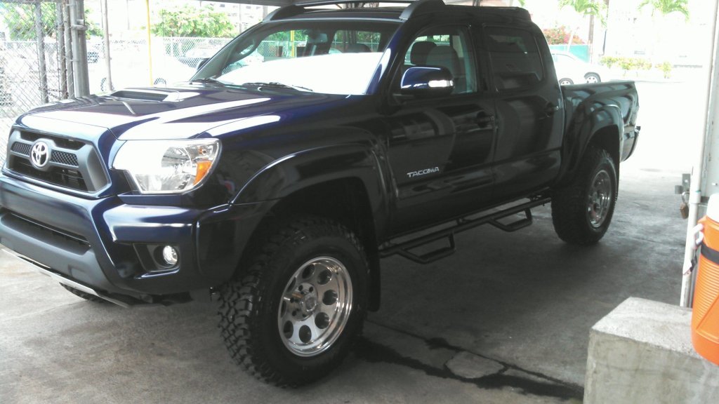

    Blown 2013 NBM DCSB Sport
    AFE CAI TRD Exhaust TRD Supercharger 3" Cornfed Spacer 2" Toytec AAL
    3"Cornfed Spacer
    2" Toytec AAL
    255/75/17 BFG KM 17x9 ProComp 1069
