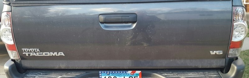

    Last weekend I managed to uncouple my trailer, got distracted and lowered the tailgate, then shifted some weight on the trailer and the tongue gave the tailgate a good whackin'.

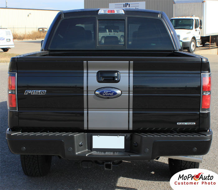

    Any creative ideas to cover up the scratches? Body shop wants $770 to redo the whole deal. Paintless dent place says he can do it for $200. There's only one dent (right under the handle) that I think I can push out from the back. The rest are scratches/gouges in the paint. I'm thinking a vinyl decal or "racing stripe" like this:F150CENTERSTRIPE_04_zpss1jfnwyw_46474f59520ddf973854dff2ec8146ee8b541ed6.jpg
    All of the damage is above and below the handle. The rest is dirt and water marks.
    Anyone with some smooth photoshop skills want to give me some ideas to consider? Just no unicorns and rainbows, please.

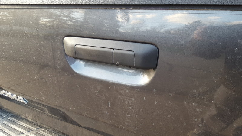

    You can maybe see it better from this angle:

    Personally I'd probably just leave it alone and use it. It's a truck.
    If I wanted it kinda better, I'd fix the dent and refinish the gate with a 'close' color from www.monstaliner.com.
    If I wanted it all purdy again, I'd find a more reasonable body shop. (I got a whole passenger door (new Toyota replacement) and a repair on the access door for only about 2x that).
    I'd de-badge the gate, remove the handle and interior hardware for them, take them the gate and have them correct the dent and paint, then do the reinstall myself. Should be no need to 'blend' into the fenders, as 1) the paint is still pretty new 2) the taillights break the 'connection', so old and new paint adjoin just a couple of inches above and below.

    As a PDR tech ....don't touch it yourself...if you choose to go PDR route...best let them have at it without creating more work/damage .... Countless times if the customer would have just left the dent alone it would have been a cleaner repair....just my .02

    While I concur with that regarding the dent itself, how can this be a PDR job? The paint is clearly broken.
    Why bother removing the dent if the finish isn't corrected?

    You'd be surprised how gentle a great PDR tech can be without further damaging the paint....if the dent is removed all you need is some color matching touchup paint....no need to repaint the whole tailgate.
    It's really all customer preference.... If the OP is looking for a %100 fresh off the production line ...then fix damage (or replace tailgate)...then paint to match....If not then there are plenty of options out there
