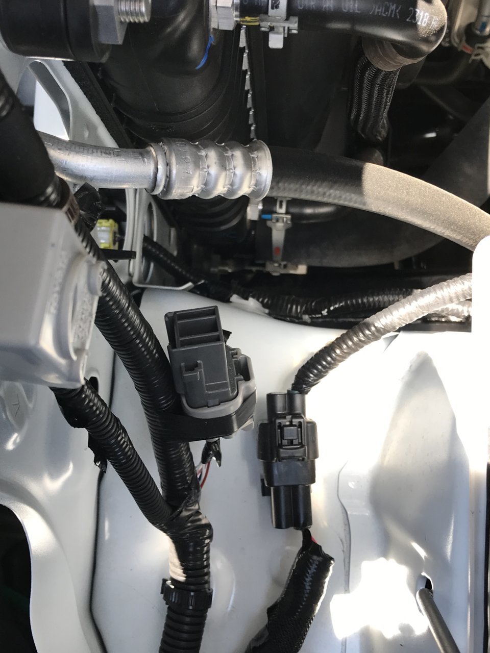

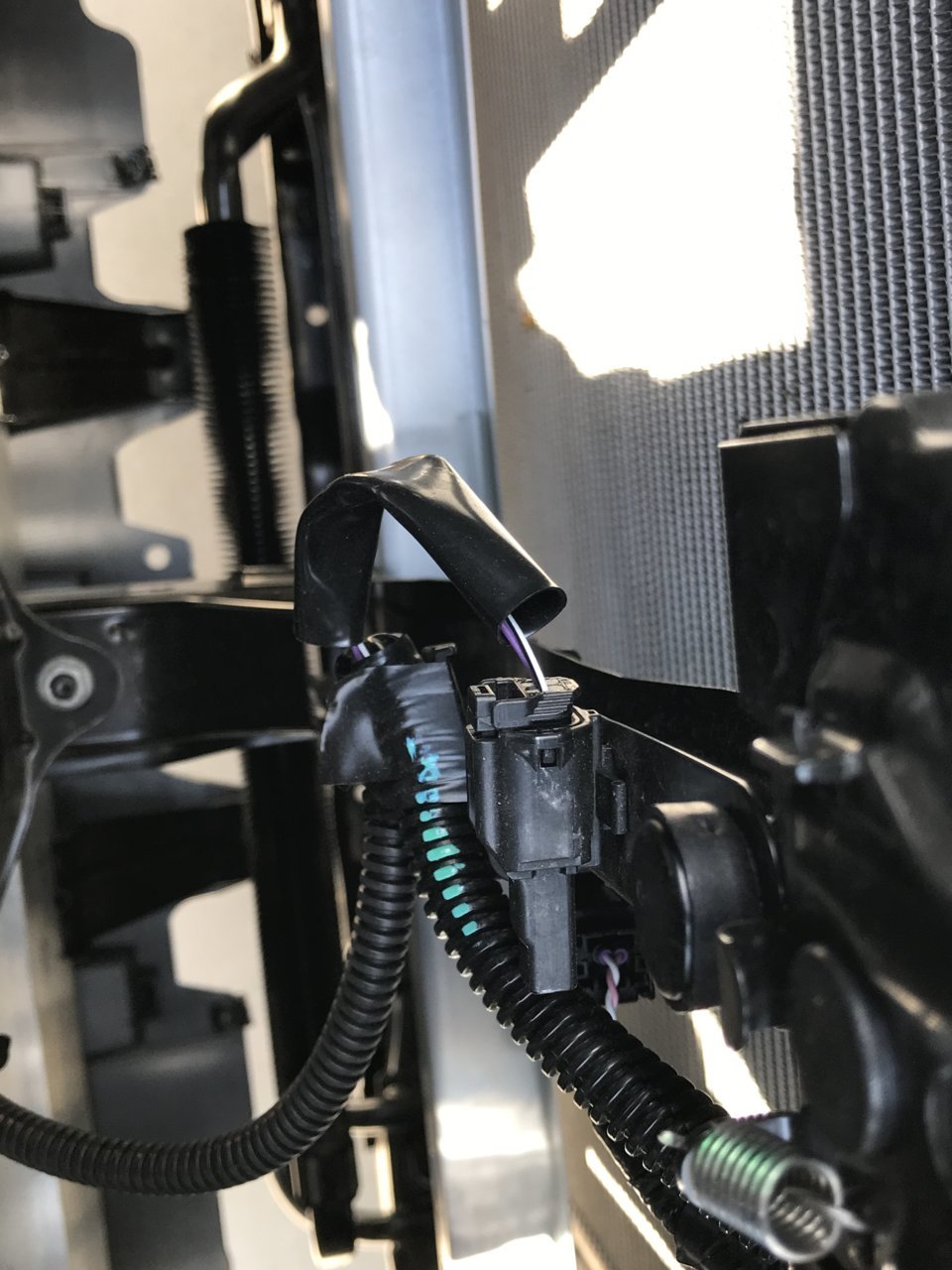

    Looking to see if anyone knows what option(s) I don’t have that connect to these wires. One is behind the grill and the other is taped to the headlight wires on the drivers side.

    I know that one of those cables/plugs is for the option front facing camera.

    #2 is your outside temp guage. It is connected.

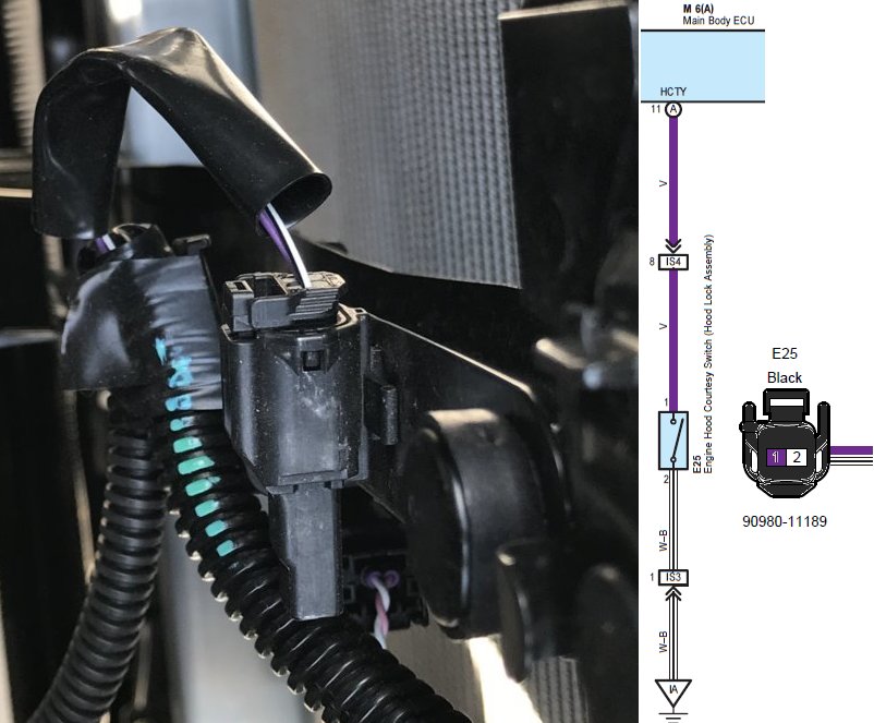

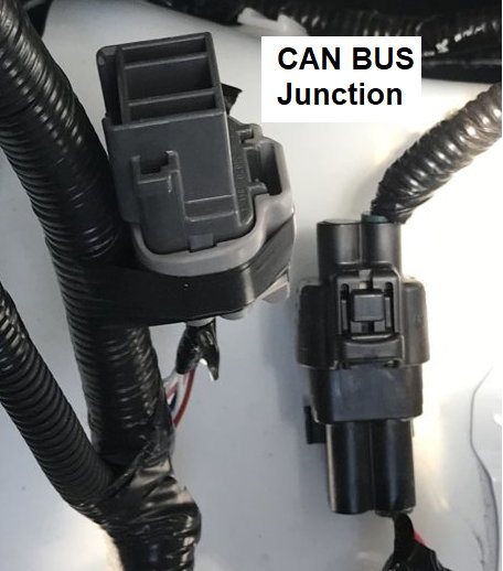

    Incorrect, all of you:

    Confirmed, both posts 13 & 14 are correct. I also thought the second OP picture was initially the ambient temp sensor as mentioned in post #4. Pictures lie when taken from a different perspective, the color of the wires did not in this case.
