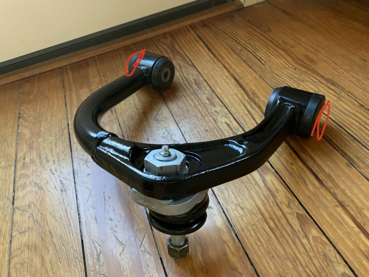

    I have what looks like the same gen SPC UCA but I didn’t get any washers when I bought them used. Do you use the “dimpled” OEM washers or what?

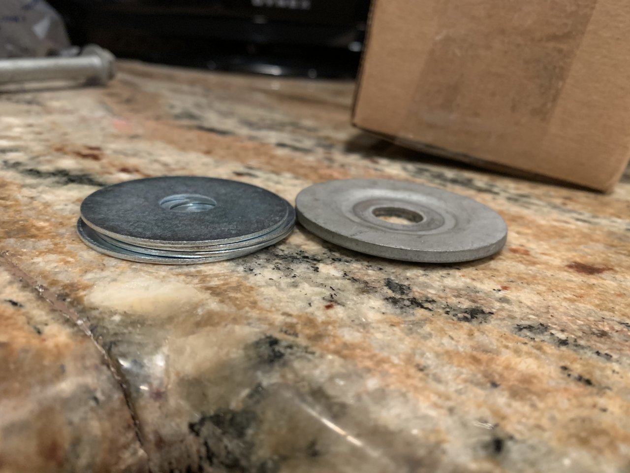

    for that style of bushing (SpecRide) instructions have it as 2 washers per UCA on the OUTSIDE of the bushing (between the head of the uca bolt and one sleeve and nut and sleeve). do NOT use the OEM dimpled/dished washers.

    So the washers would go where the red marks are? I could only find these thin washers, do you think if I stack them they would work?
