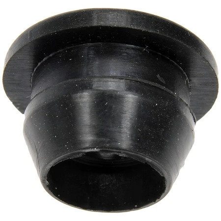

    I ordered one of those too. Different model for mine but same spot. It requires a nasty bend that can get kinked really easily.

    Yeah a bunch of you are driving around with a massive vacuum leak.....
    right at the grommet.......and bunch of them'...., its just the top left.....the lower lip has rotted and dropped off into the engine.....
    Fake grommets....
    The older the engine.....the worse the blow-by gases eat the rubber.....especially at 200F.......
    Damn good thing those ecm's are built to handle upto +/- 40% fuel trims......
    and you not even know it......unless you live scan.........
    dont know how lucky you guys are.......
    Old and crispy.....I once tried a better one from napa....higher quality of rubber.....
    boy that was a big mistake......
    .....almost couldn't get that sucker out of there.....it had turned into concrete after 10 or 20K.....
    definintly an 'Oh shit' moment....
    dorman's from auto zone is way to go.......
