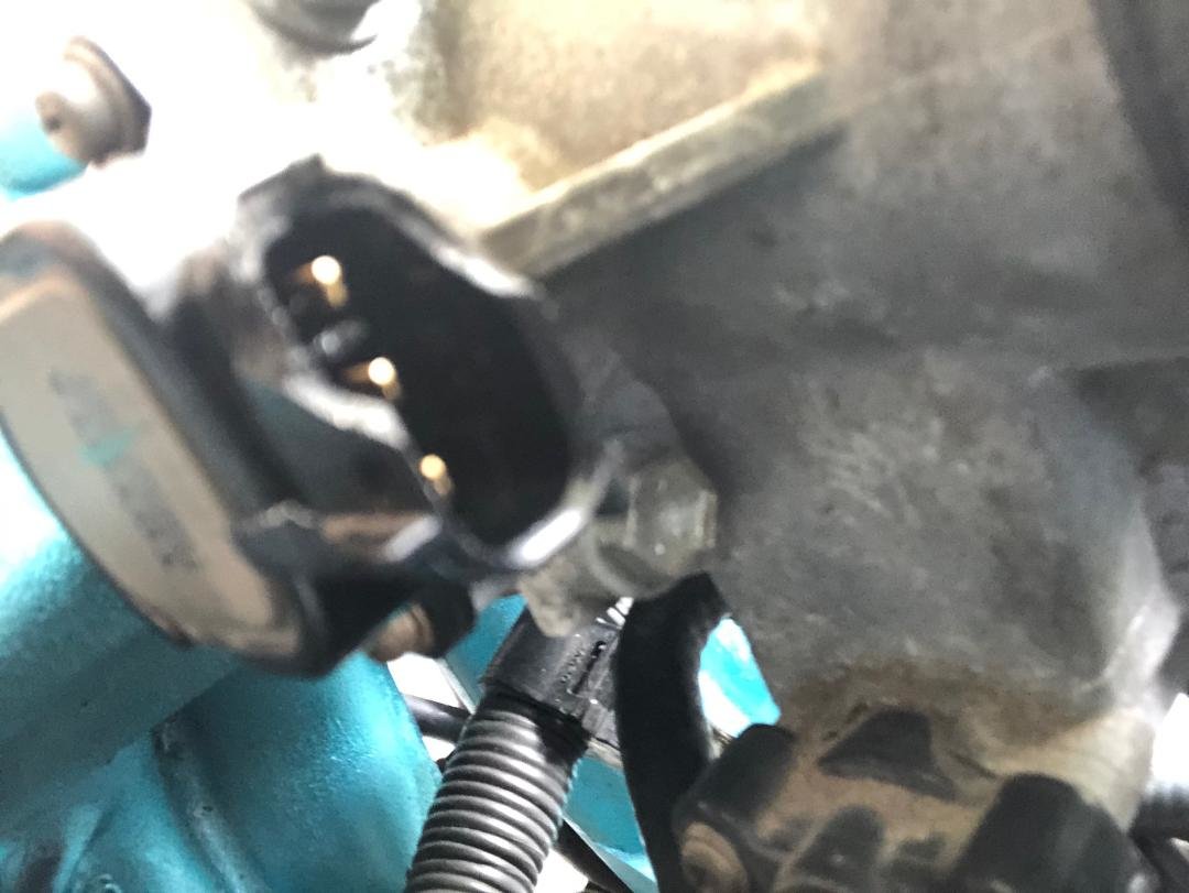

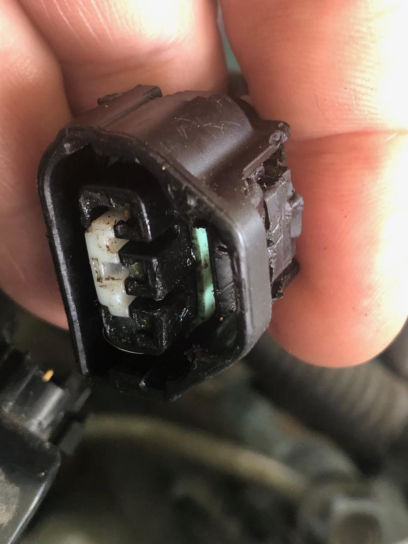

    I am still having problems with the IAC on my 04. 2RZ. In the pic, the shroud is broken on the plug. If it were not for that break, it would not plug in. I have tried pushing the tab. Pulling up on the tab. It won't go on. I am ready to replace both the IAC and plug. Does anyone know of a source for this plug? It comes from the truck wiring harness, and attaches to the IAC at its plug receptacle.
    Thanks.

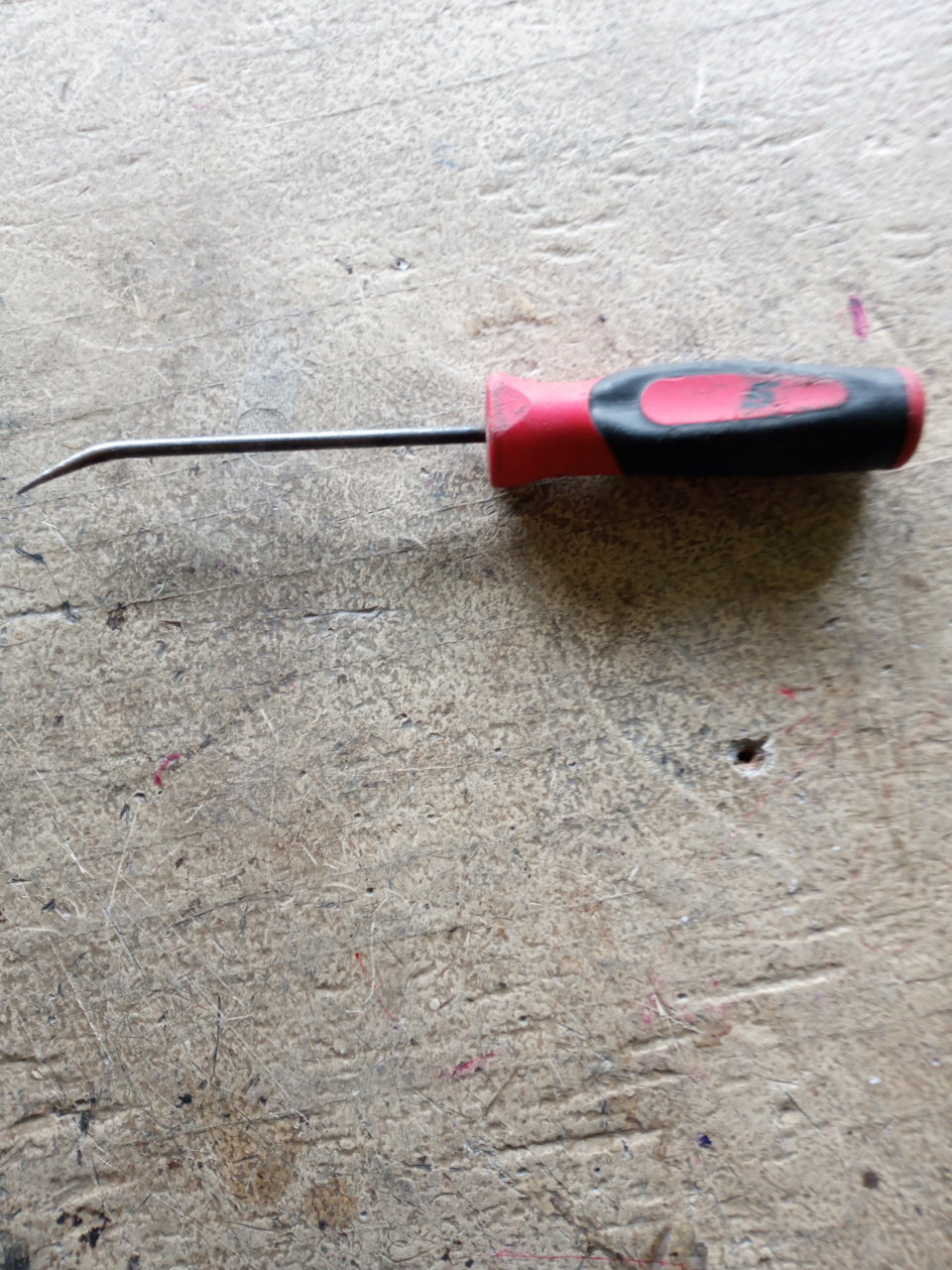

    IMG_20230404_171826_717.jpgUse this and patience

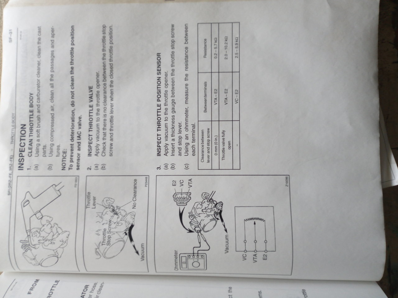

    IMG_20230406_130549_560.jpg2003 Toyota Tacoma

    ^ that
    But also the ECU is very good about throwing a TPS code when they're bad in my experience.
