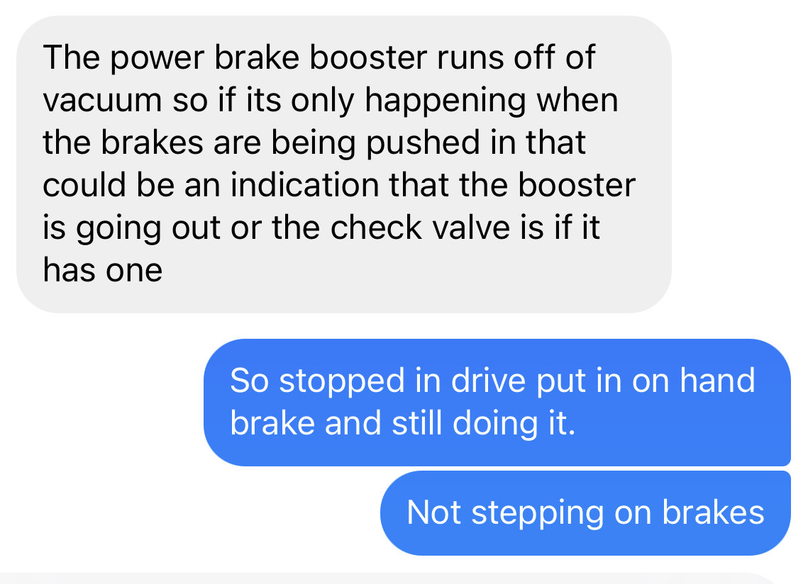

    someone did tell it might be vacuum issue.

    You brake booster doesn't run off of vacuum. Are you by chance moving the steering wheel when this happens? That will make the rpms fluctuate.

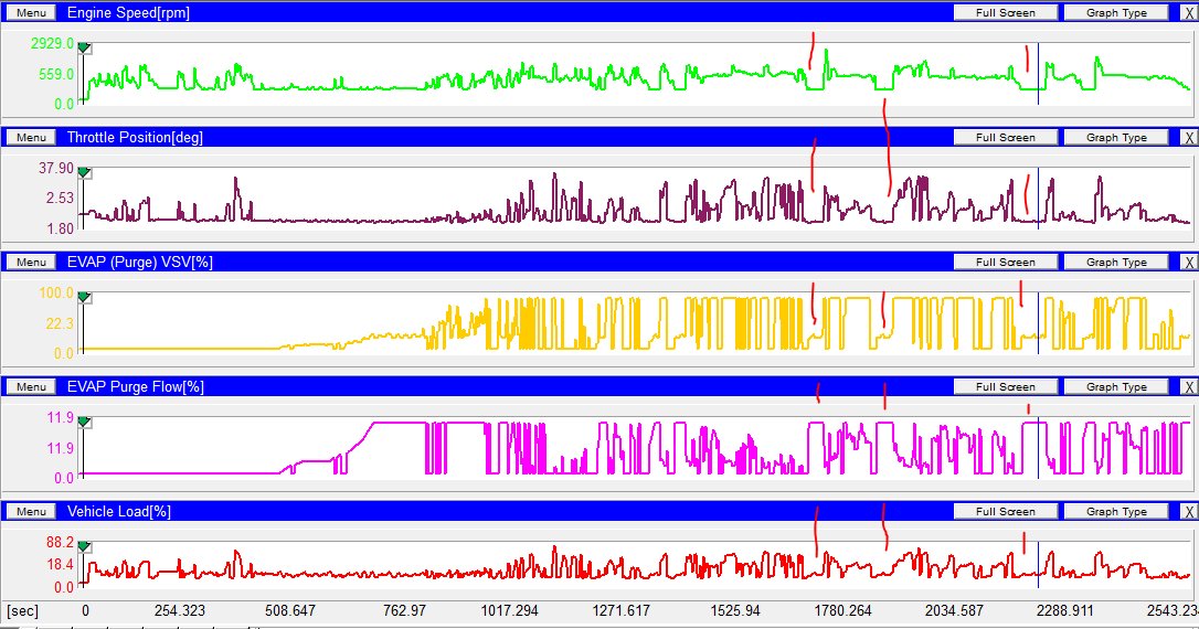

    OP, EVAP Purge contributes to the idle fluctuation.
    The clutch fan, a/c in different modes, lights increase the load on the engine. Also, on the hot idle, the engine will run on Direct injection mode to clean DI injectors.
    here is the EVAP purge at the idle. RPMS fluctuate about 50-60 rpms.

    Fortunately you don’t have a vacuum brake booster to go bad and cause this issue.
