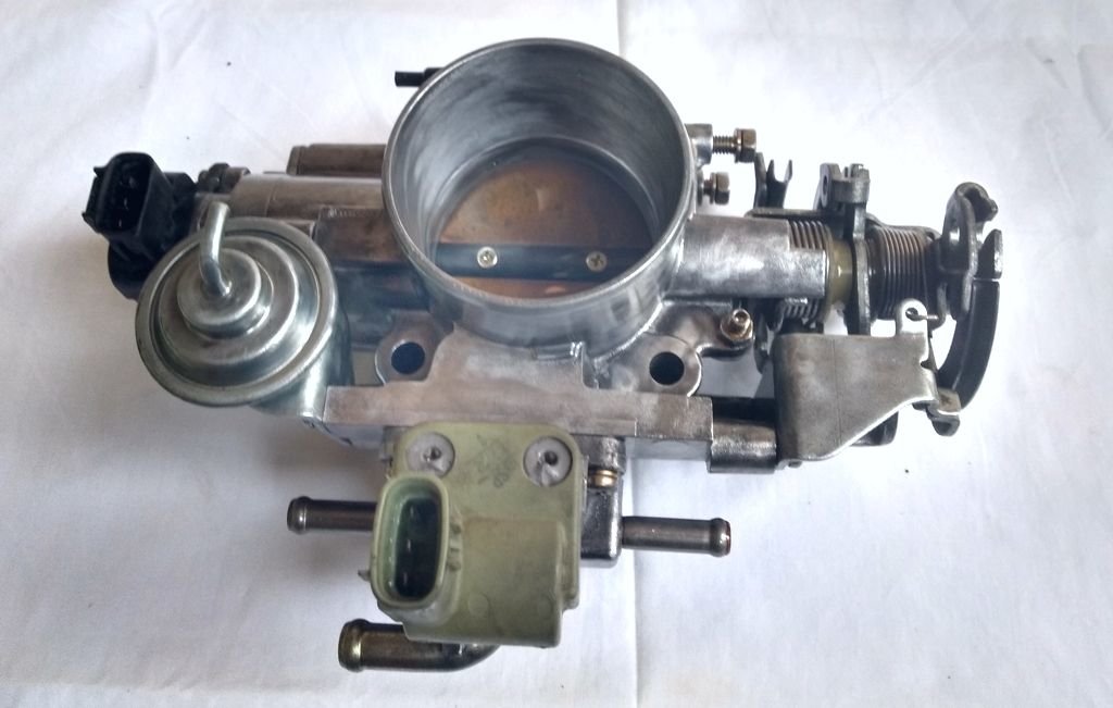

    +1. I just cleaned mine and put in a new gasket with the engine rework. Idles perfectly.
    For the OP, the IAC is part of the yellow-greenish part with the plug in this picture.
    NOTE: the Phillips looking screws that hold the IAC to the throttle body are not Phillips but a type known as Japenese Industrial Standard (JIS). Be careful not to strip the heads if not using a JIS driver.

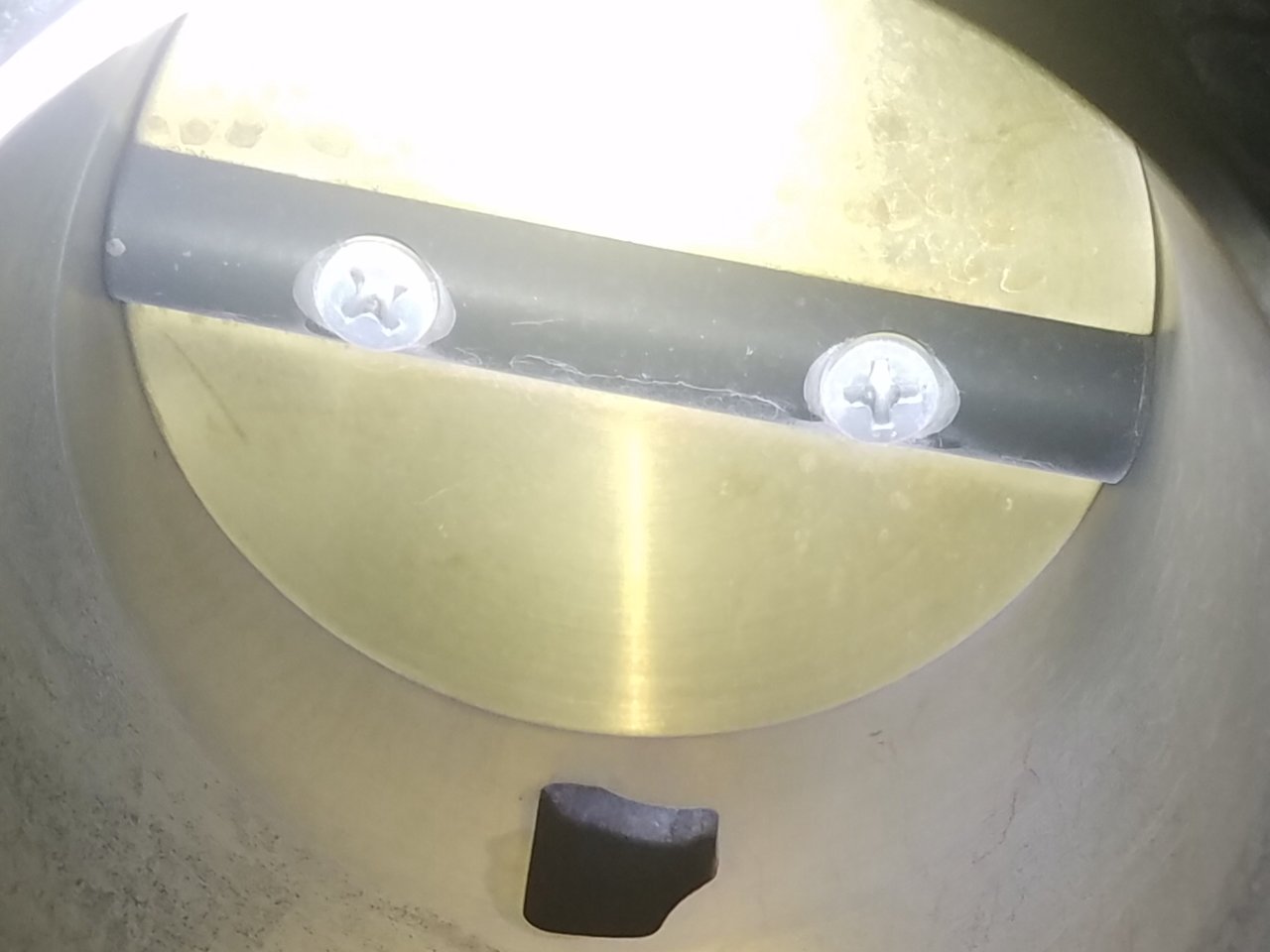

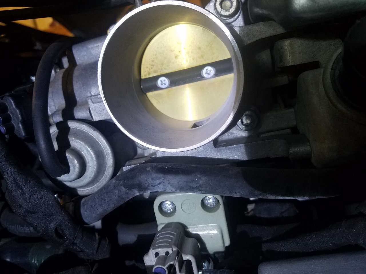

    When you clean or examine the throttle body butterfly there should be little to NO air gaps around the walls and the butterfly. Just enough of a gap for the butterfly to move is all on the top section and tight on the bottom section.
    If there are any large gaps this will also create a high idle.
    This is a common problem as the wall of the throttle body where the butterfly meet
    gets a low spot.
    Run your finger across this spot with the butterfly open to see if you feel a low section.
