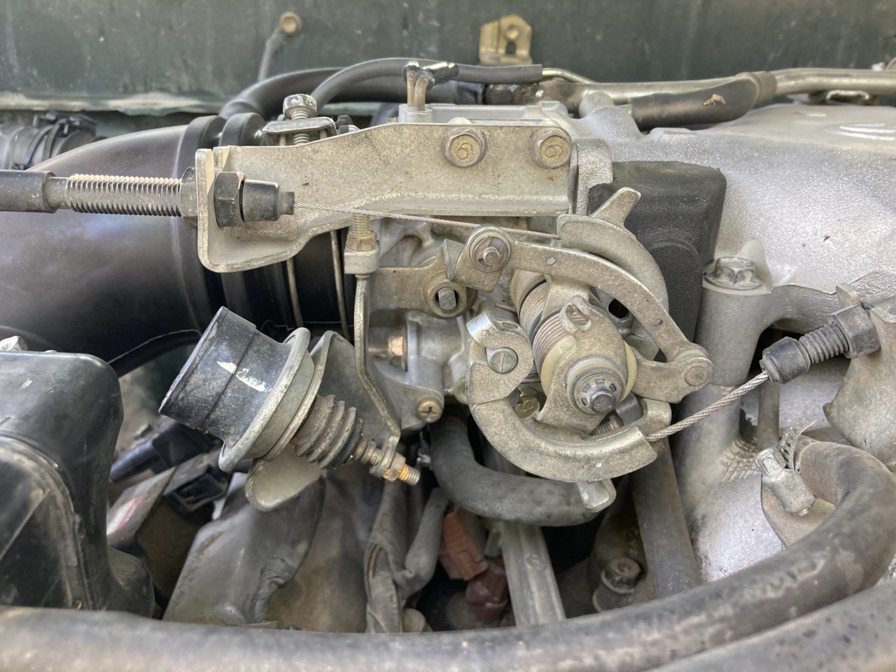

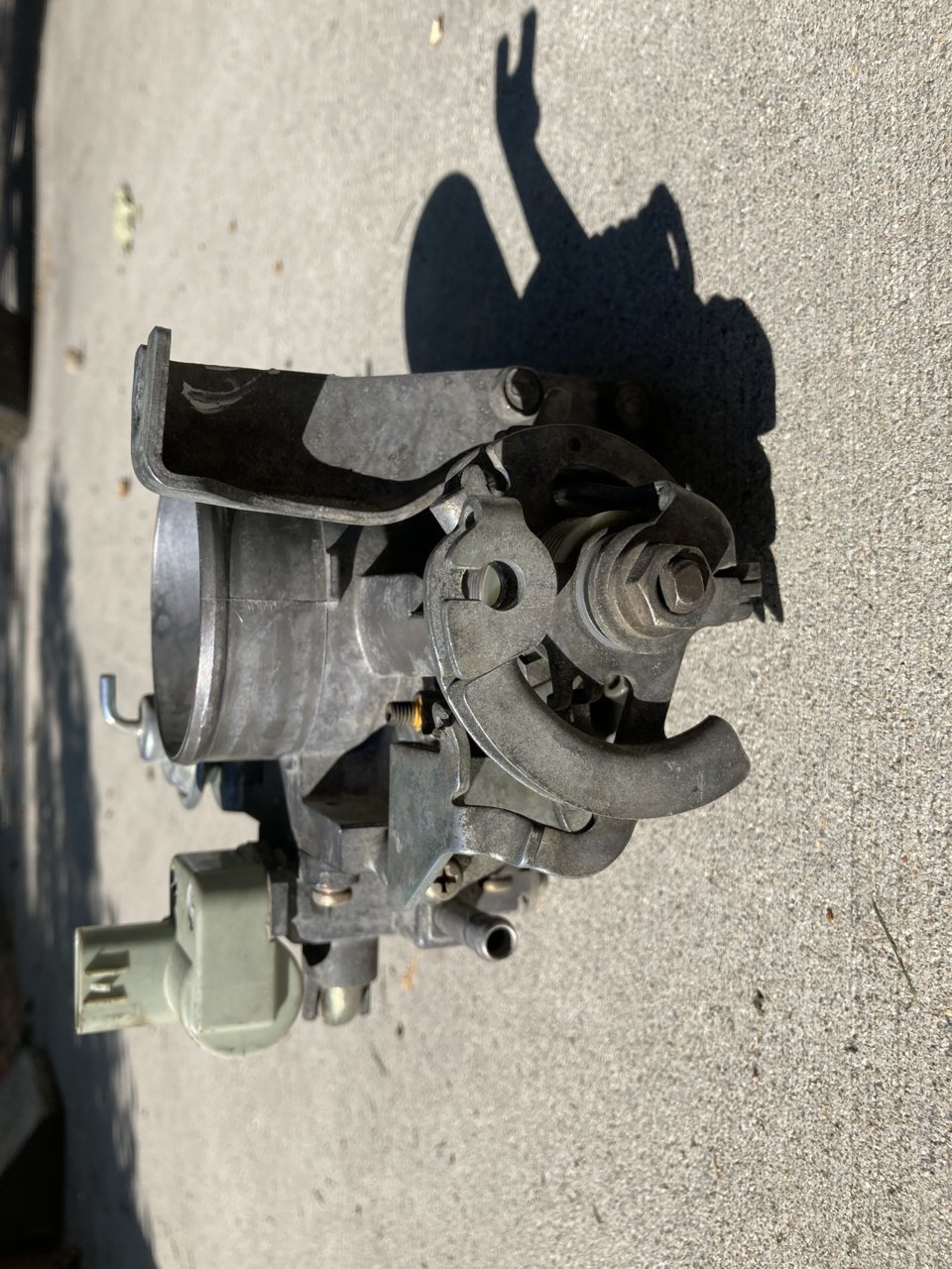

    Oh now I remember what it was…Auto doesn’t have a dash pot on it. That and the length of the TB is different, while yes you can make one off an auto work…without the dash pot isn’t the best.
    Searched for months for one from several dealers, unfortunately it has been discontinued.
    Auto.
    Manual.

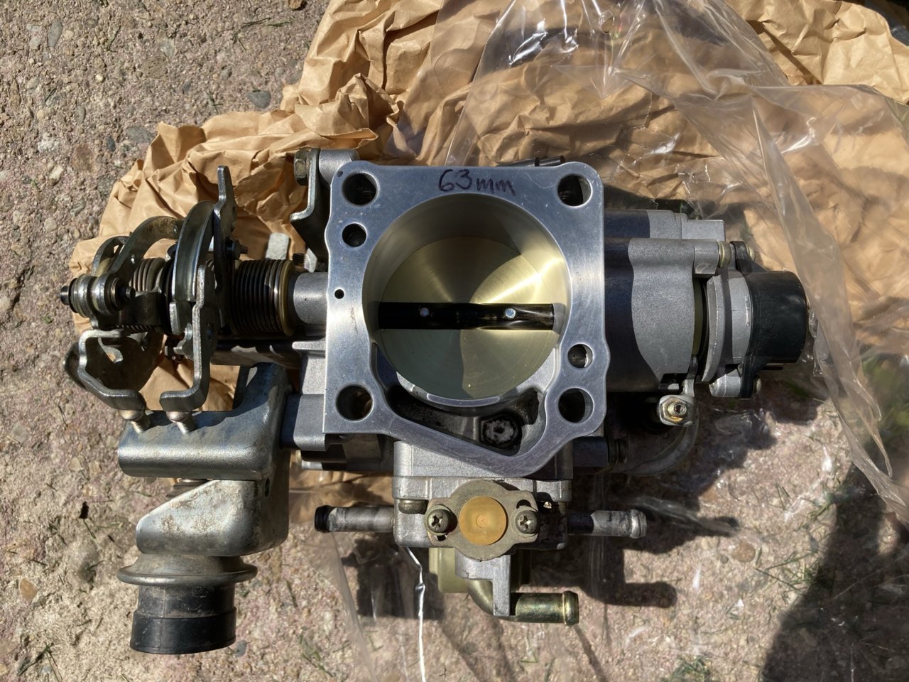

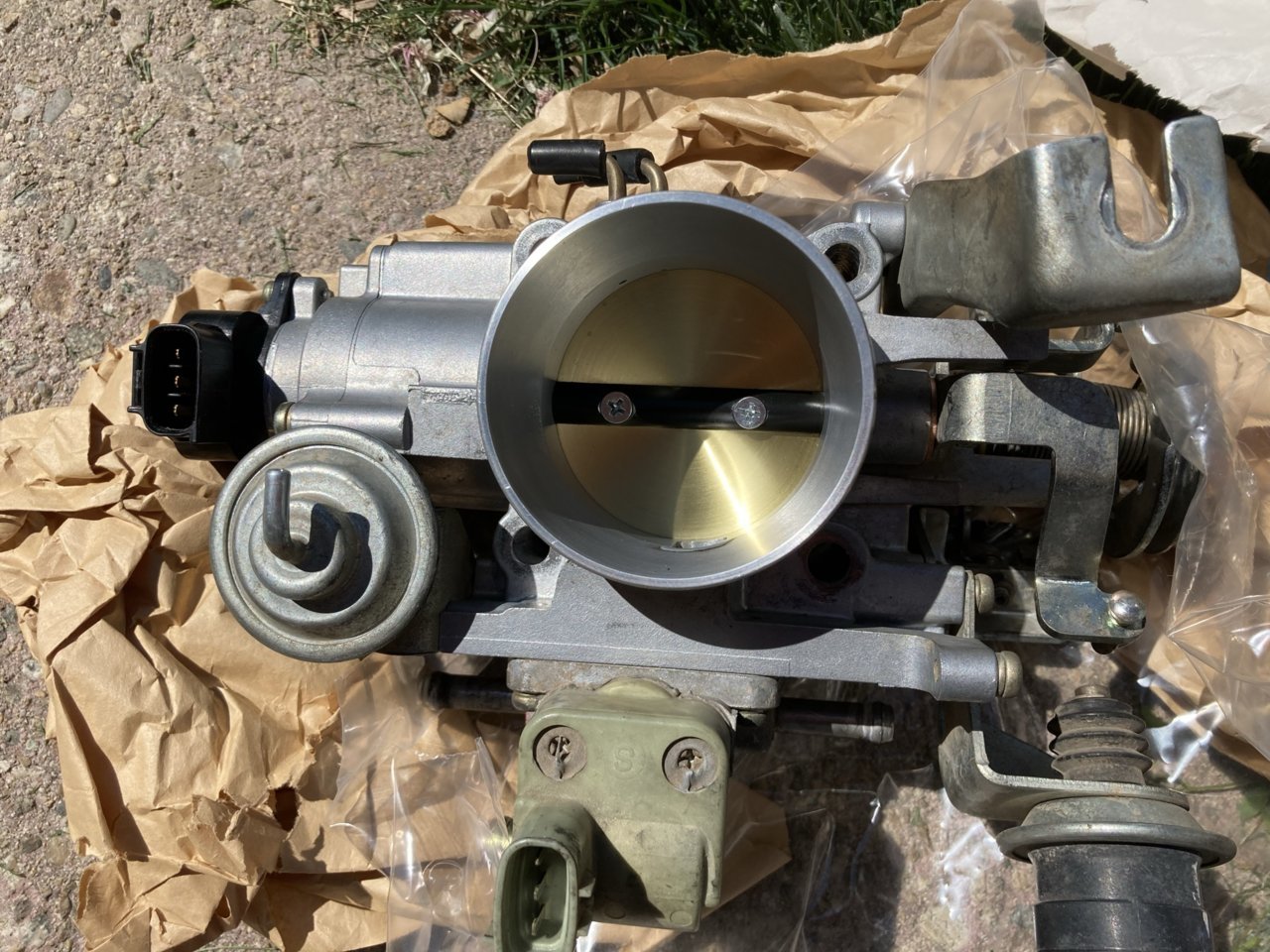

    You’re welcome. It won’t hurt anything, just be annoying. Drove mine for months while I looked for a solution. Check local hot rod shops, they might be able to do it for you. Could always buy a spare from a salvage yard, which may cure the issue…or at least make the truck drivable while yours is getting bored and a new butterfly.
    When I first put mine on after rebuild it wouldn’t idle, disconnecting the battery for 10 seconds to reset it cured that.
    Here it is after, nice and tight again. Notice no space around the butterfly and the bore.

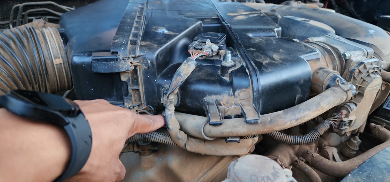

    Paint black with gold pearl with camper
