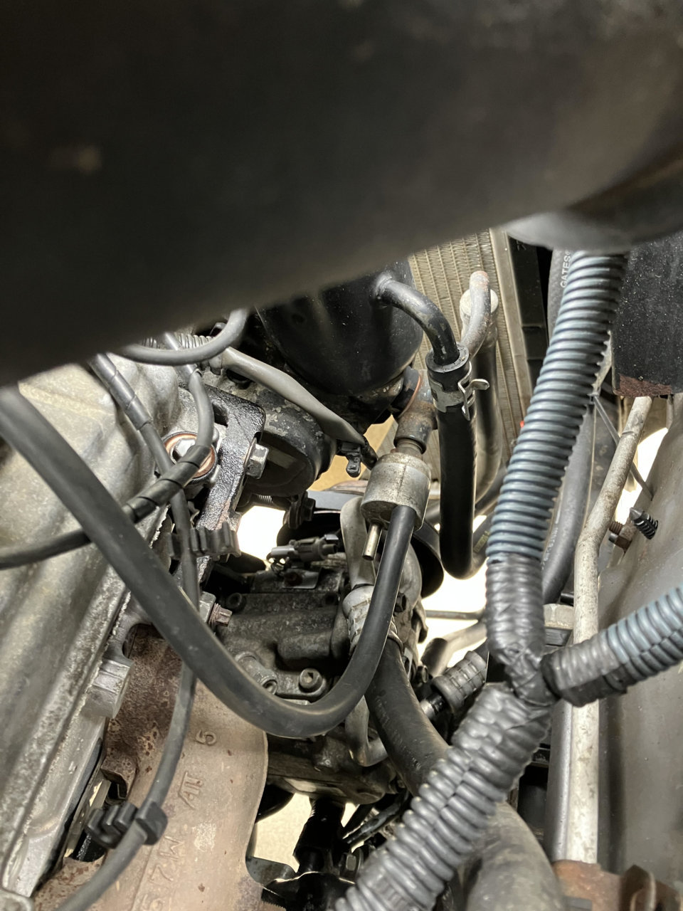

    Hey guys,

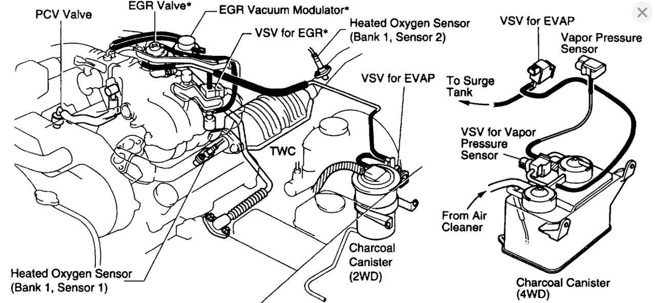

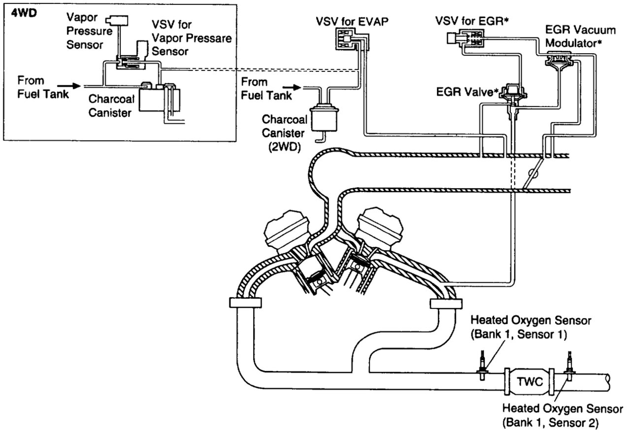

    Thinking back to when I first got the Tacoma, there was a broken VSV in the front of the engine, above the timing cover. It was just kind of dangling with no real place to be. I bought a aftermarket replacement that didn't fit. Truck ran fine without it, but I'm really trying to tighten this Taco back up. What would be the symptoms of this delete? I'm sure they put it there for a reason. Just identified it in a 5vzfe Schematic and made me remember.

    @Bivouac what do you mean the electrical side should be open? Also I am looking at the schematics and it looks like one port runs to the air cleaner, but can't seem to trace back where the other port goes.

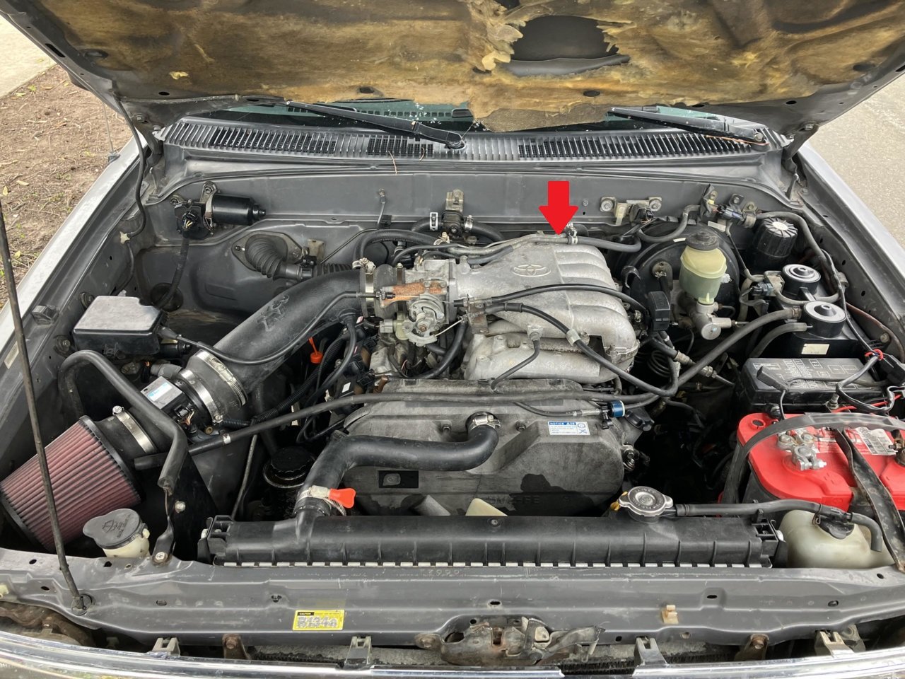

    Do you have a picture of your engine bay?

    Hear it is, whats that little blue check valve thing doing on the right side of the timing cover.

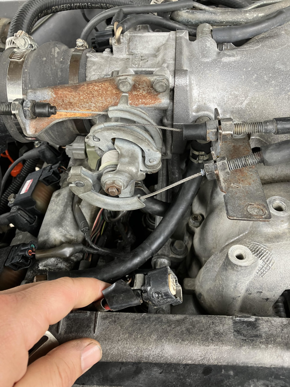

    Found the Connector also

    Okay so something is weird here. Was your engine swapped from something else. You have the 1998+ intake manifold that only has a single front nipple and the wrong thing is connected to it.
    Check and see if you have an unused nipple where my arrow is pointing, it would be on the back side and pretty noticeable.

    Yup thats the idle up connector, and I have a spare one of those valves and the bracket you're welcome to but your intake manifold is the wrong one for your year, it is missing the nipple for the valve.

    Spark plug wires are missing their holder too and I don't see the power steering load vacuum line either.

    That blue check valve is for the 4WD system, it's a check valve/filter. Keeps those solenoids from getting mucked up with oil/fuel vapor from the manifold
