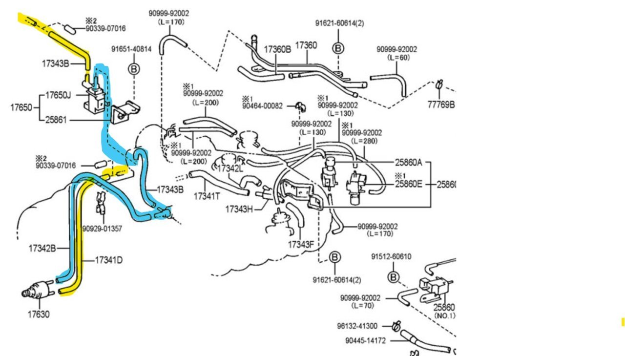

    @Speedytech7 no o2 sensor, that's about the only thing I'm missing from the first schematic. Other schematics im getting lost

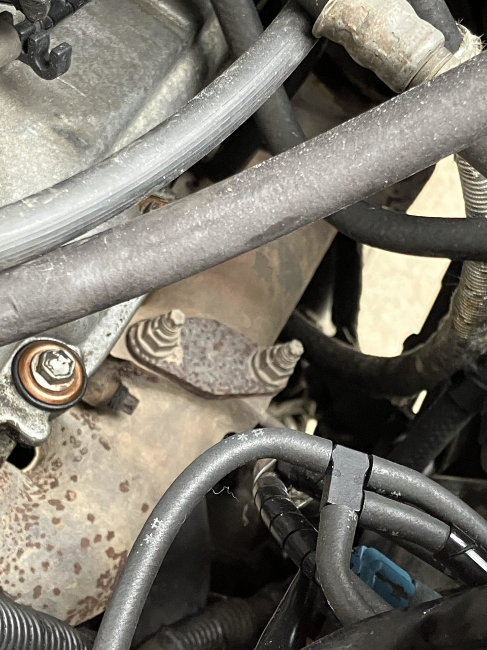

    @Speedytech7 maybe that o2 sensor is underneath by that cat, diagram made it look like it was on the headers where that bung plug pic was taken. Everything looks to be good, do I just need to tap in to some other vac lines?

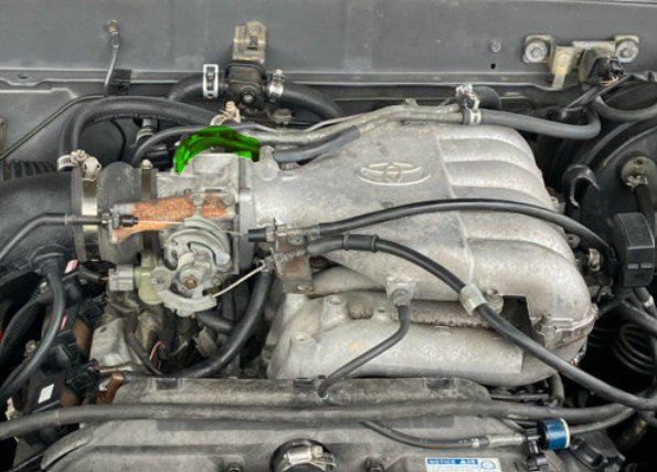

    This seems to be the routing for the Idle-Up VSV. Looks like it comes from filtered air and then connects to the PCV hose? Hard to tell if it connects to the PCV hose or somewhere else. I don't know what that box thing is on the intake.
    Thanks for the help.
  4. May 15, 2023 at 10:52 AM
    #24
    Speedytech7
    Feb 20, 2014
    #123587
    57,672
    FCQM+VG Cheney, Washington
    It's less Tacoma and more mod
    Yeah the idleup goes from the resonator on the intake tube to the nipple on the front of the intake manifold, but yours is all hooked up wrong and has the wrong nipple, so you'll need some vacuum line and a couple vacuum tees.

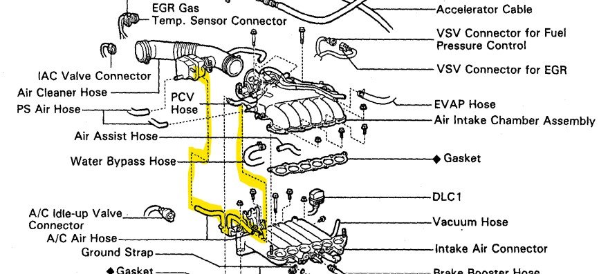

    @Speedytech7 This schematic makes it look like the P/S and the Idle-Up look like they are sharing the line
  6. May 15, 2023 at 11:03 AM
    #26
    Speedytech7
    Feb 20, 2014
    #123587
    57,672
    Yeah they both go to filtered air from the tube and then dump into that nipple on the intake manifold (your nipple should have two inputs but doesnt)

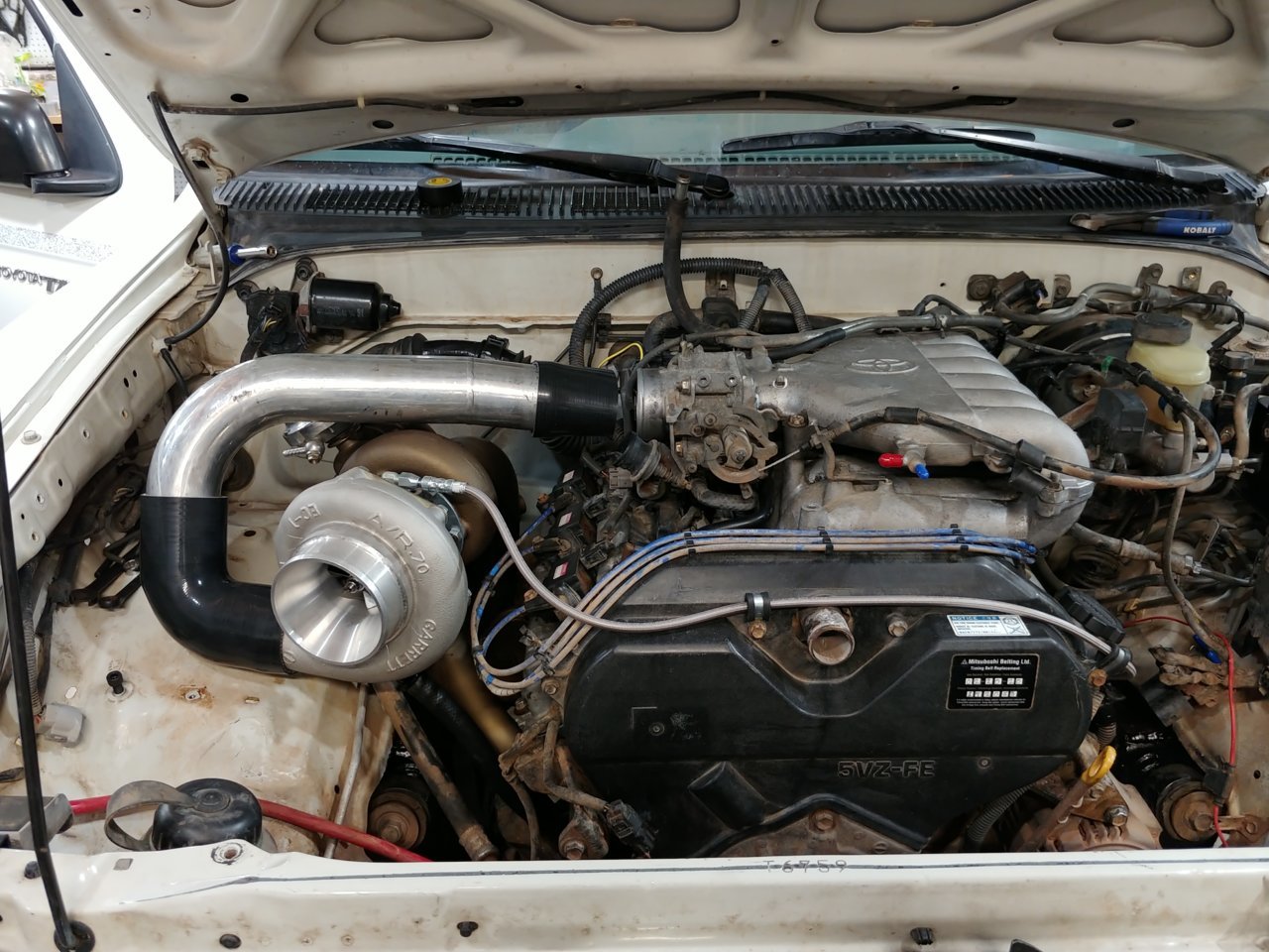

    @Speedytech7 yeah i see that is a completely different intake than I have. It seems since I don't have a port to install the Idle-Up and P/S. would the Idle-Up effectively be running in its off position?
    PS: That turbo is awesome. I bet that thing Juices!!!!!
