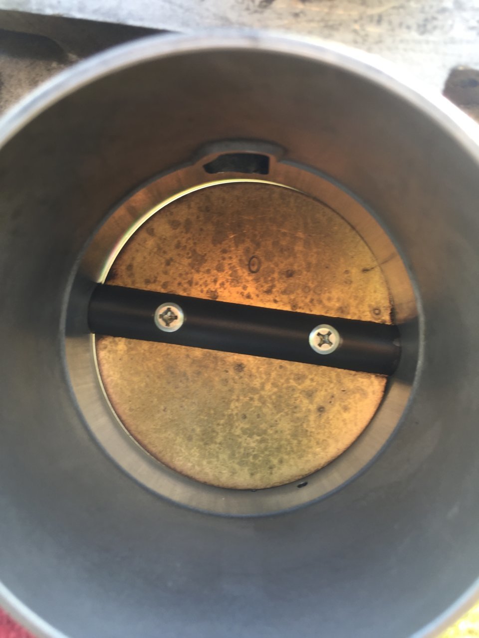

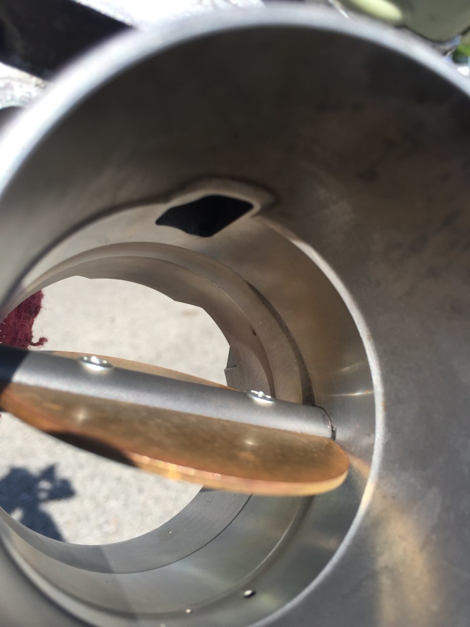

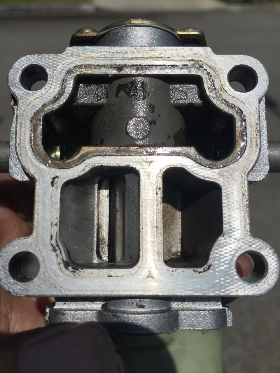

    Removed the throttle body and the IAC and gave them a thorough cleaning. IAC rotates but I did not test as I wasn't sure which of the 3 leads to connect. One thing I noticed was that it was a little loose, meaning when turning the gate mechanism by hand it was loose for about a 16th of an inch before it engaged with the spring. Not sure if that matters. Reassembled and it runs much smoother at speed but idle is still high.
    BTW the CEL was an O2 sensor error which I cleared and which has not returned, so I think it might have been a reaction to the new air fuel mixture from the cleaning.
    Some pics of the throttle valve etc. below.4137DD00-FF64-491A-AD06-56ADE35BDA00.jpg0EC0CE8B-75F7-4382-B11B-EE24D0EDEF58.jpg

    Still could be the IAC I suppose, have you sprayed any brake clean on your vacuum hoses just to rule out a leak? My money on high idle issues is usually the IAC.
