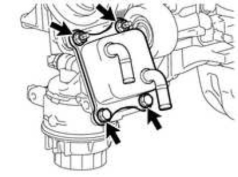

    Well that's the right view .....any idea what it entails taking it apart any thing I should be thinking about before removal or torque specifications for the oil housing or the tensioner? I do have to remove the entire cooler not just the top

    32 ft-lb on the idler pulley
    15 ft-lb for the 2 nuts and bolt on the oil filter assembly

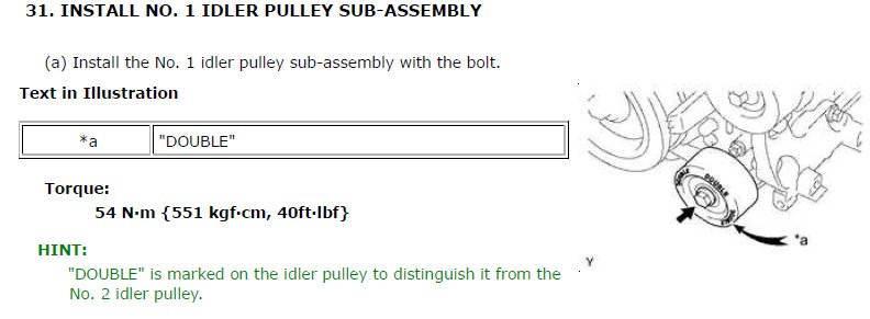

  12. Dec 10, 2019 at 4:38 PM
    NoOne
    NoOne El Taco Guapo
    Feb 6, 2018
    #243575
    5,547
    Ø ©
    Gulf South
    2022 Tacoma DCLB OR (AT) - BC
    2018 SR5 - (Sold) 2018 OR - RIPieces 2022 OR - BluCrush
    30. INSTALL NO. 2 IDLER PULLEY SUB-ASSEMBLY
    (a) Install the 2 No. 2 idler pulley sub-assemblies with the 2 bolts.
    Torque: 43 N·m {438 kgf·cm, 32ft·lbf}
    HINT: "DOUBLE" is marked on the idler pulley to distinguish it from the No. 2 idler pulley.

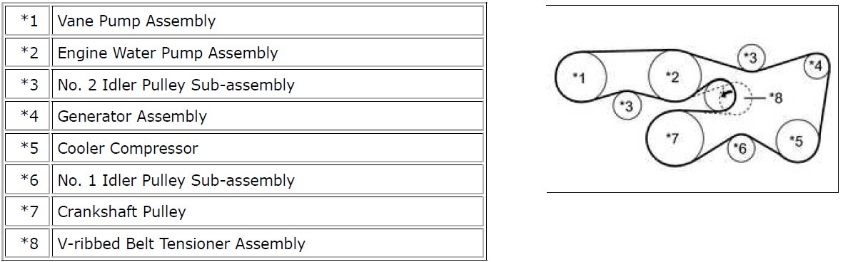

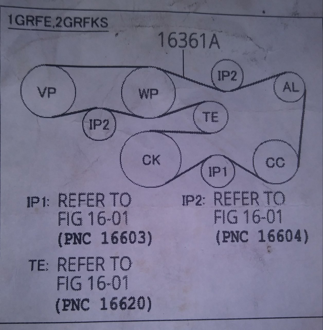

    Did the job today all went as planned except the belt routing it is wrong I will post the proper routing tomorrow

    The one toyota gave me is wrong this is the right one

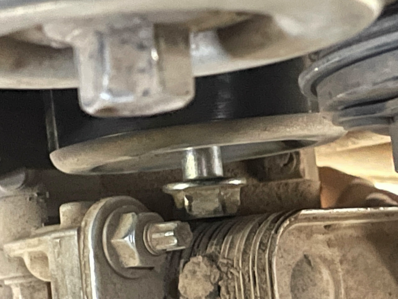

    Reviving old thread.... Can you not drop the skid plate and do this relatively easily from underneath or is the oil cooler still in the way? For the lower pulley
  20. Aug 17, 2021 at 6:00 PM
    #20
    mccgsm
    mccgsm Member
    Dec 21, 2018
    #276533
    10
    Gary
    2017 Burnt Orange double cab TRD Offroad
    Me. Put me in the driver's seat.
    It is still in the way per photo--taken from above but doesn't matter: you cannot replace the lower idler without pulling the oil filter mount. I've seen good engineering and I've seen bad, but this is just malicious engineering: these vehicles are intended to be used offroad and exposed to adverse environments like mud, sand, grit, etc. My idlers needed replacing at 60K even though my engine is protected by full length skidplates. But unless you have the foresight to pack an extra gasket and can figure out how to clean the crap off a dirty, oily exposed engine part, you ain't gonna do a field repair on this. I was ticked with the brake light leak that Toyota left on the backs of owners and I've long hated the stupid two-piece oil filter, but this pissant design is sending me to other brands when I (soon) replace the Tacoma.
    And adding to all this, I added the Tacoma to my AllData subscription--and discovered that Toyota doesn't even give any instructions whatsoever to remove the oil filter mount. That means that 2021 Toyota is providing less information to users than Jeep did for my 2006 Wrangler. To me these are all signs of a company that rests on its past and doesn't care about the present or its customers....
