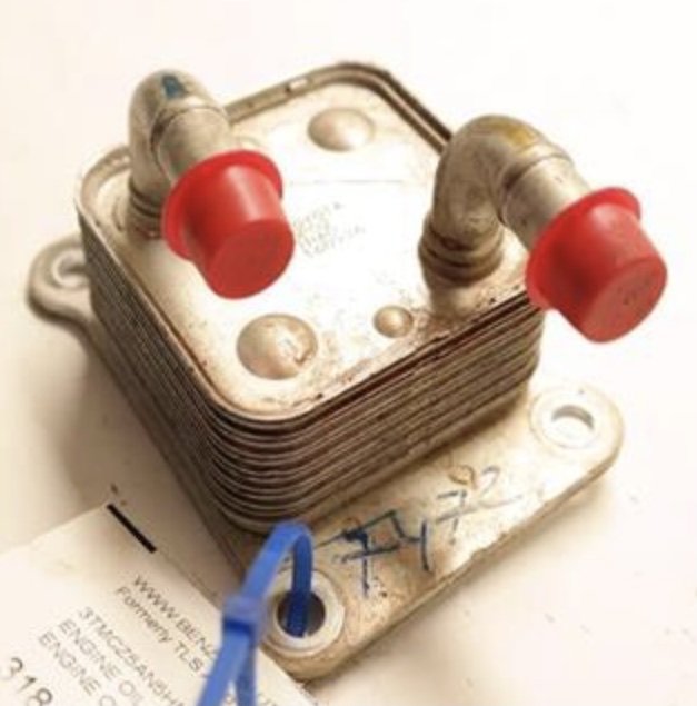

    For some reason I don't recall seeing that cooler on my truck before, maybe l just haven't noticed it.

    This reminds me of a comment/observation my father (EE/PE) once made. In the past, draftsmen were experienced craftsmen or aspiring engineers - who knew what the parts were and what they looked like. Today’s CAD operators have no idea and only go by the templates they have. Physical possibility is merely an afterthought for the implementation team. I would love to see what Toyota wrote for the service manual and book rate.

    2020 TRD Sport Access Cab 4X4 MT
    It's part of the towing package. For your MY it was an option. It later became standard on TRDs if not all V6s. But if you have the towing package you should have it.

    2018 SR5 - (Sold) 2018 OR - RIPieces 2022 OR - BluCrush
    Well, that means I probably have it. I’ll have to take a look at it. Perhaps a shifted plate can be added to relocate it with enough clearance. Machined aluminum isn’t cheap, but worth the sanity.

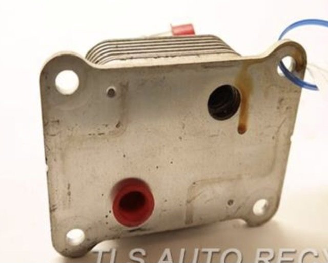

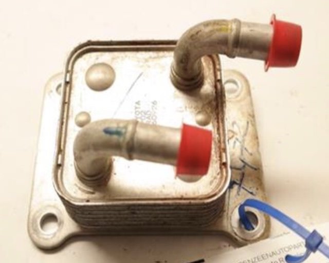

    I’m looking for a used one to dissect, but perhaps it is even easier… is there an aftermarket cover for adding an oil cooler to non? Or is the housing different/blank on non.

    North Adams, MA
    I have a non oil cooler bracket somewhere... fairly sure the pulley is not blocked by it.

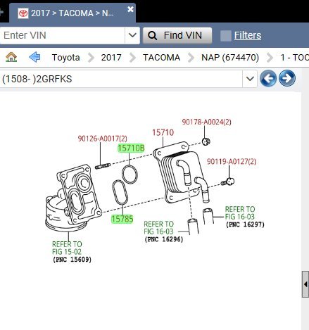

    Red Tacoma
    Are there replaceable gaskets behind the housing, if so do you know their part number?

    12,064
    4 orings, 2 sets of 2.
    You can reuse them in a pinch.

    Red Tacoma
    Are they pretty universal in size? I have a multi pack of O-rings. I can't seem to find a part number for them.

    12,064
    No I’ve never been able to use universal on Toyotas. Re using is better that wrong.
