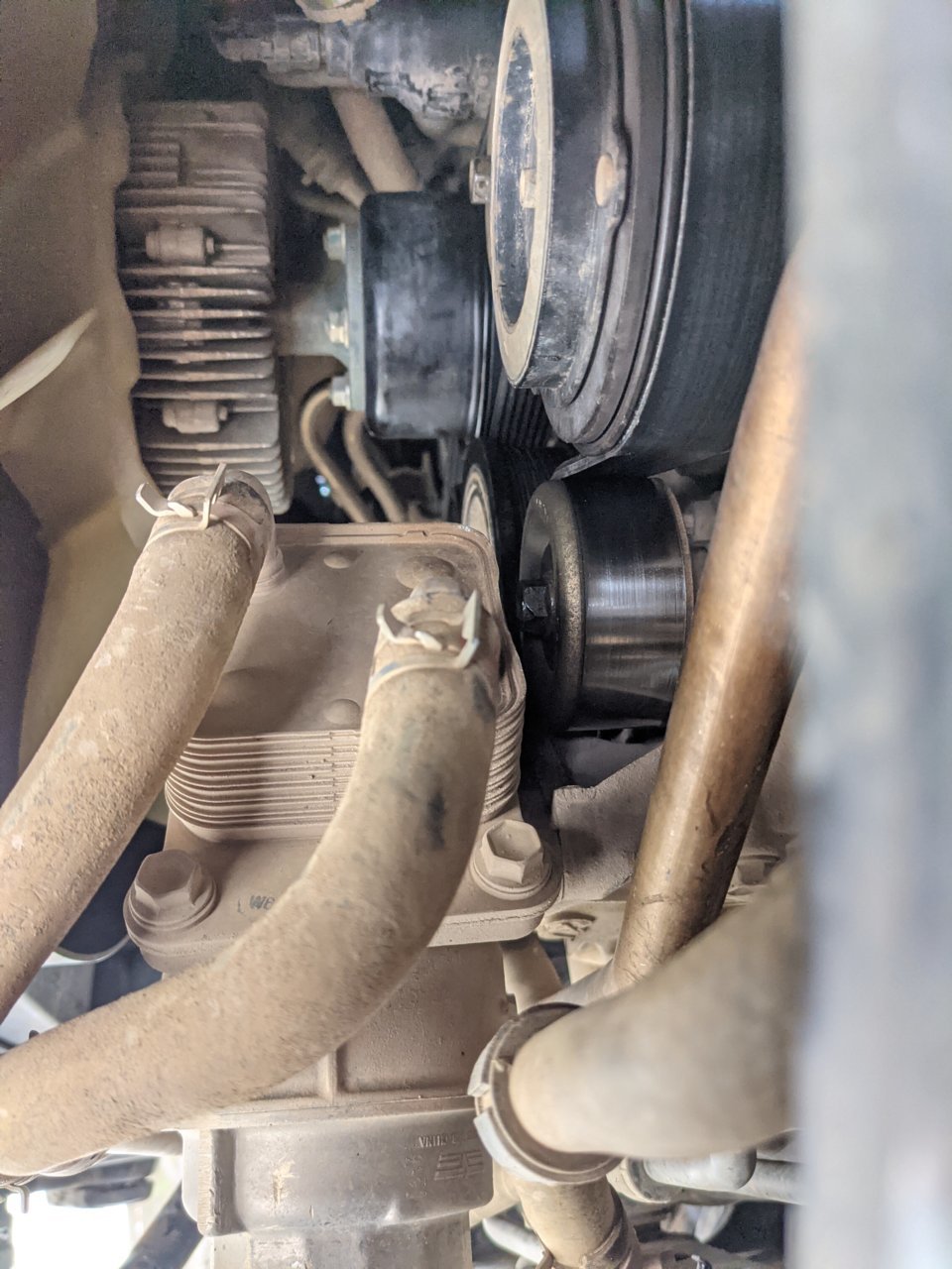

    I think my lower idler no 1 is bad. I can't get a good enough grip on the bolt because of the oil cooler. Can I simply unmount the cooler and move it temporarily to replace the pulley or does it need to be more extensive?

    @b3itz - are you attempting removal from the bottom? On OEM setups, there is no need to remove anything but the belt and lower brackets that prevent the approach from the bottom.

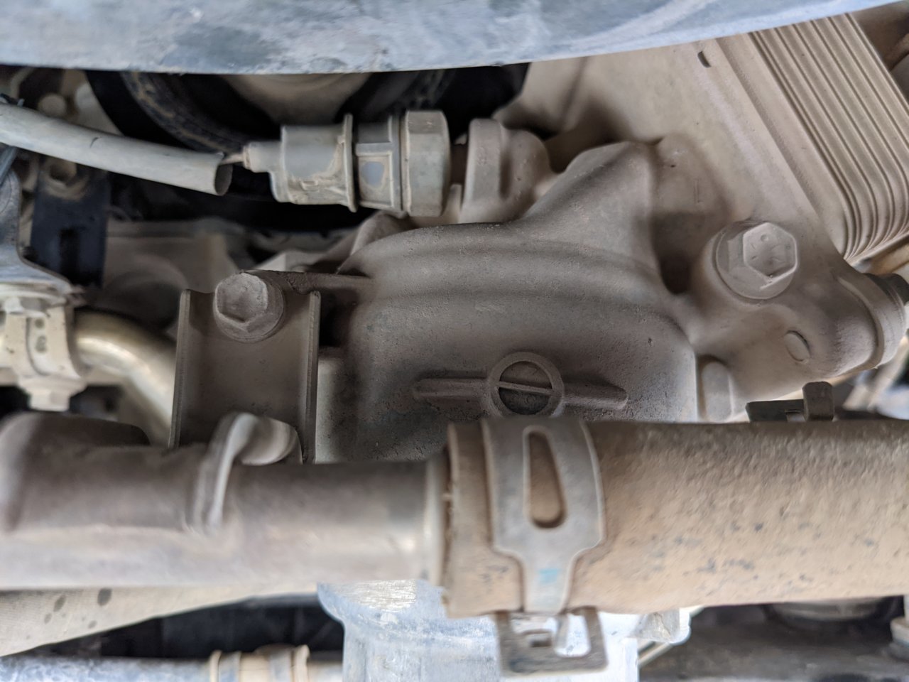

    Cool so I popped off my skid plate and I see I can get there from under.
    What lower brackets?

    Silver Taco
    @b3itz - They are the mounting brackets for the skid plate. You may only need to remove the driver side one, or not - for me, removing it made it easier to rotate my ratchet.
    Edit: actually, for using my pry bar on that bolt.
