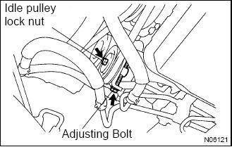

    The 3.4L has 3 belts, one for each accessory. The belt adjustments are at each of the accessory units.
    So, to relieve the belt tension on the A/C idler pulley....you need to loosen the tension at the A/C condensor unit. That's where the tensioner is. The bolt in the center of the A/C idler...is only to remove the pulley.
    Putting new bearings in won't work unless you get the proper bearings that can handle the RPM load. I tried that on mine and the grease oozed out within 2 days of putting the bearings in. Too high RPM's and the bearings got too hot and couldn't handle it. They need to be special bearings.

    WRONG, the AC belt is tensioned by the idler, the centre bolt locks it and the lower bolt tensions it.
    And by the way if you would have got a sealed bearing (like I did) you would have had no problems ( like I still do a year later)

    That's not how mine was on my 96 3.4L. The pulley was fixed and bolted into one place. So, they must have changed things since 96.
    The Condensor was what tensioned the belt. And Yes, I used sealed bearings and they didn't work.
    If you look at the top of this picture....that's the one off my 96.

    I'm not convinced, what is that bolt sticking down at 5 o'clock of the tensioner?
    As for the bearing, you must have got a shitty one, mine is fine a year later, with a good number of river crossings that went over the head lights, so I know its been submersed and abused.
