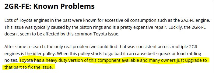

    A little more info on the pully . Scroll down to the part about know problems for the 2GR .
    https://dustrunnersauto.com/2gr-fe/
    Sounds like a solid design if it is the only common problem .

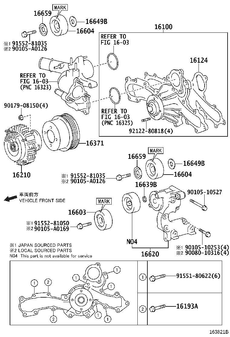

    It says it’s part 16604 in the diagram.
    What’s the heavier pully part number?

    Not sure about heavy duty one? You have and engine schematic that shows the location. Also how does the tensioner come loose

    copy and pasted from the article...this exactly describes what's going on
    After some research, the only real problem we could find that was consistent across multiple 2GR engines is the idler pulley. When this pulley starts to go bad it can cause belt squeak or load rattling noises. Toyota has a heavy duty version of this component available and many owners just upgrade to that part to fix the issue.
