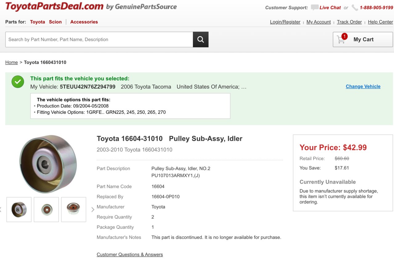

    I did however, find them on ToyotaPartsDeal. The 31020 result is it does not fit my truck and the 31010 fits, but is discontinued.

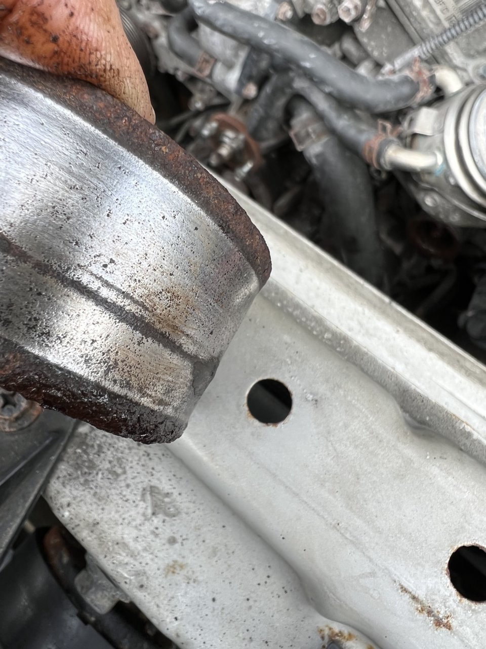

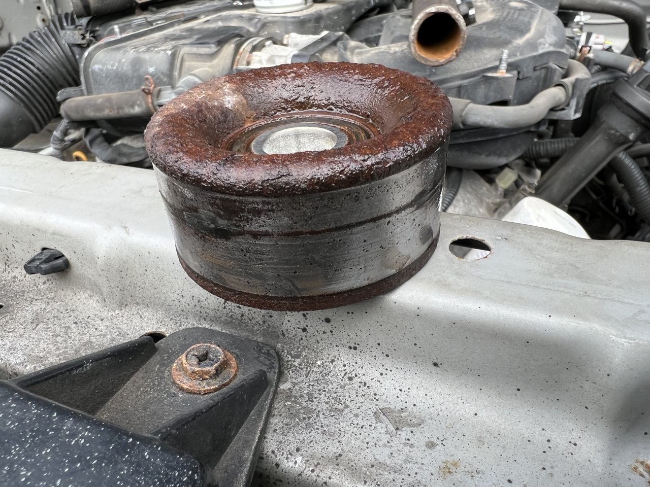

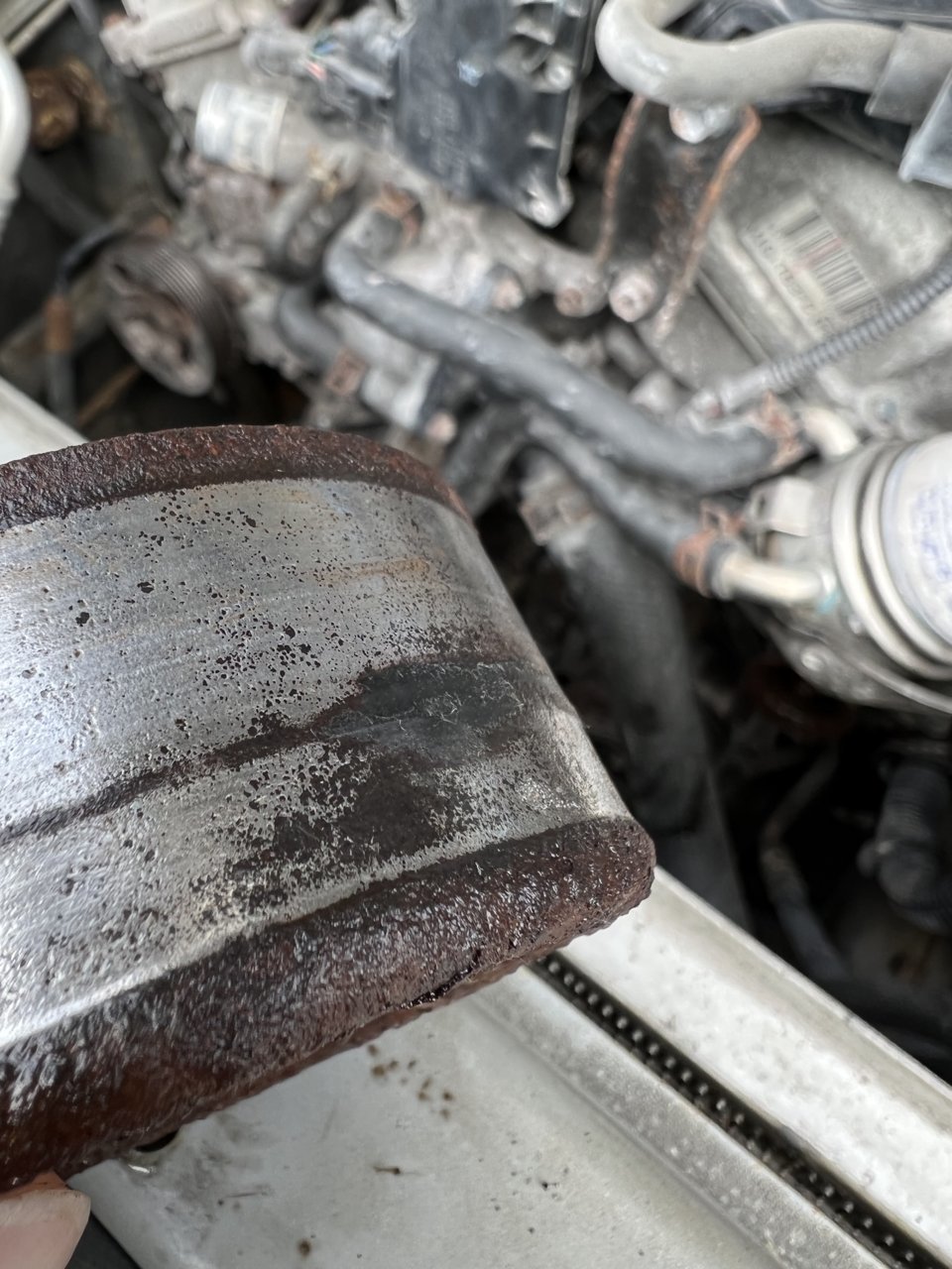

    Looks like build-up on my tensioner pulley was what damaged the belt. Anyone know why this would happen? Obviously pressing new bearings into this mess isn't an option. I cleaned it up with a wire wheel but the metal is actually raised up. So my only option I assume, is to buy the whole tensioner assembly, correct? Blah... lArCufJjSnSSkjzlIMhA9Q.jpg vtAbX6%IRvqnKGlUbpuUvA.jpg Z9N6w9RAS7iwnbkbdP5ZDw.jpg

    Have to assume that if the pulley looks that bad the spring in the tensioner is probably shot so just do the whole assembly. Gave you info on it in post #23 to install. If your coolant has not been dropping due to a leaky water pump or thermostat housing it's just 16 years of crappy environment.

    Rust and mileage, will wreak havoc. I wouldnt think anything is wrong to cause it other than that. Just a wear item(s)
