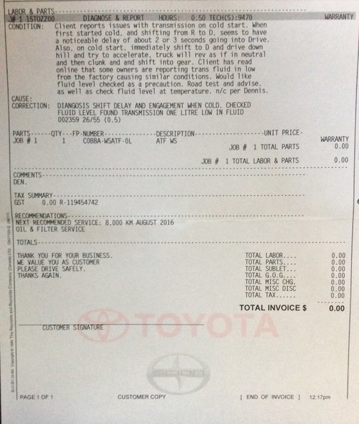

    I got my transmission fluid level checked today on my automatic at the dealership. I'm currently at only 1,000km on the odometer.
    To be honest, if I had never come on this forum I never would have even thought there was anything to complain about with the transmission. But, seeing so many people complain I wanted to get it checked as a precaution. I haven't noticed any real problems other than the delay shifting from R to D when cold.
    I started by writing an email to the service manager saying that I don't really have any big problems, I've just read online that a lot of people do. He told me to bring it in the next day, no charge to check it. He even detailed to me that they would bring it to the correct temp and then pull the overflow plug (not a diagnostic scan).
    So they checked it, and it was one liter low, and then topped it up.
    Short test drive home and I am amazed how much of a difference that liter made. At normal acceleration, I can hear it shift, I can see the needle move, but I can barely even feel it.
    Dealer write up for info....

    I am, unfortunately. Took mine in due to hesitation from r to d. They added some fluid or said they did. Thought it was better, but it's not. On my way now for second visit. First time I went with two issues and had to wait for a part. So whatever.
    I am dropping off overnight so hopefully the late engagement can be "recreated." Today after work I swear it didn't fully engage into drive until it rolled 10 ft.
    I really hope this gets resolved or I am going to be upset. It's ok if no one is around, but when backing out downtown into moving traffic it is unacceptable.

    Do you need to know, or care?
    Your tranny fluid is low. Make sure when you drop it off that they do the reverse to forward in the morning, insist on it!

    Tech only got paid .5 when it pays .7 or 1.0 depended on what op code it used. No wonder nobody wants to check fluid at the dealer
