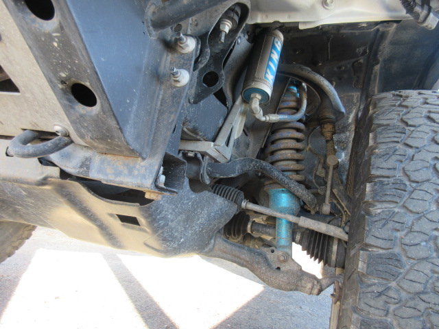

    Good info here, I agree the Bilstein 6112 and 5160 are good for levelling and a good ride. Sold the fronts (15trd pro 6112) kept the 5160 out back, and got some adjustable kings up front. 2 clicks off the soft setting and they are NICE & plush yet controlled ride. Overkill for my mall crawling but fun to experiment with. I might try some TRD Fox Pro after just cuz it's fun to feel the difference in design, progressive vs digressive etc.IMG_20191108_071255.jpg
