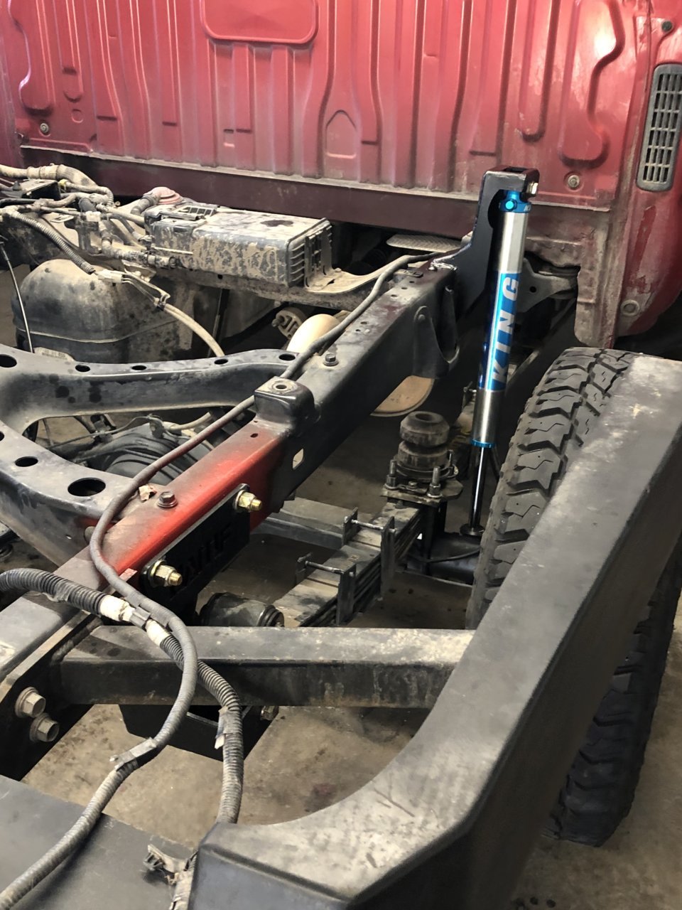

    The shock relocate kit is money well spent hell still comes out cheaper than just oem geometry Kings if you go with the smoothie no resi like I did. You should into a HD hanger as well I went with BAMF for my setup and have been extremely pleased with it.

    Was it absolutely necessary to remove the bed to mount the new bracket, or is it just recommended?

    No probably not but it made the install 100x easier. The bed is really easy to remove just have a friend to help pick it up.

    Shoot, it might actually workout better to remove the bed so I can install a 1" body lift at the same time. Haha
