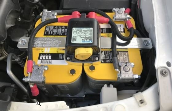

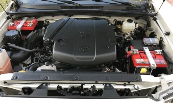

    Agreed. One way to avoid this is a dual battery setup (link is not working for some reason - off grid 4x4 dot com). If you own a sport you will need to go with the setup pictured below. PRO and Off-Roads can go with the other battery in the passenger corner at the firewall. Many overlanders use this type of configuration to power firdge/freezer combos. The setups isolates the batteries so the fridge will not drain the battery used to start your rig and you can manually isolate the batteries. I have this on my list of electrical upgrades for this year. Run your electrical heater and whatever else off of the 2nd battery and the voltage sensing relay will charge it back up once the vehicle is running.
    Sport needs the side-by-side b/c of the ABS valves in the passenger firewall side
    Pro and OR can go split dual batteries.

    Sick setup man, I need to add that to my growing list of mods!

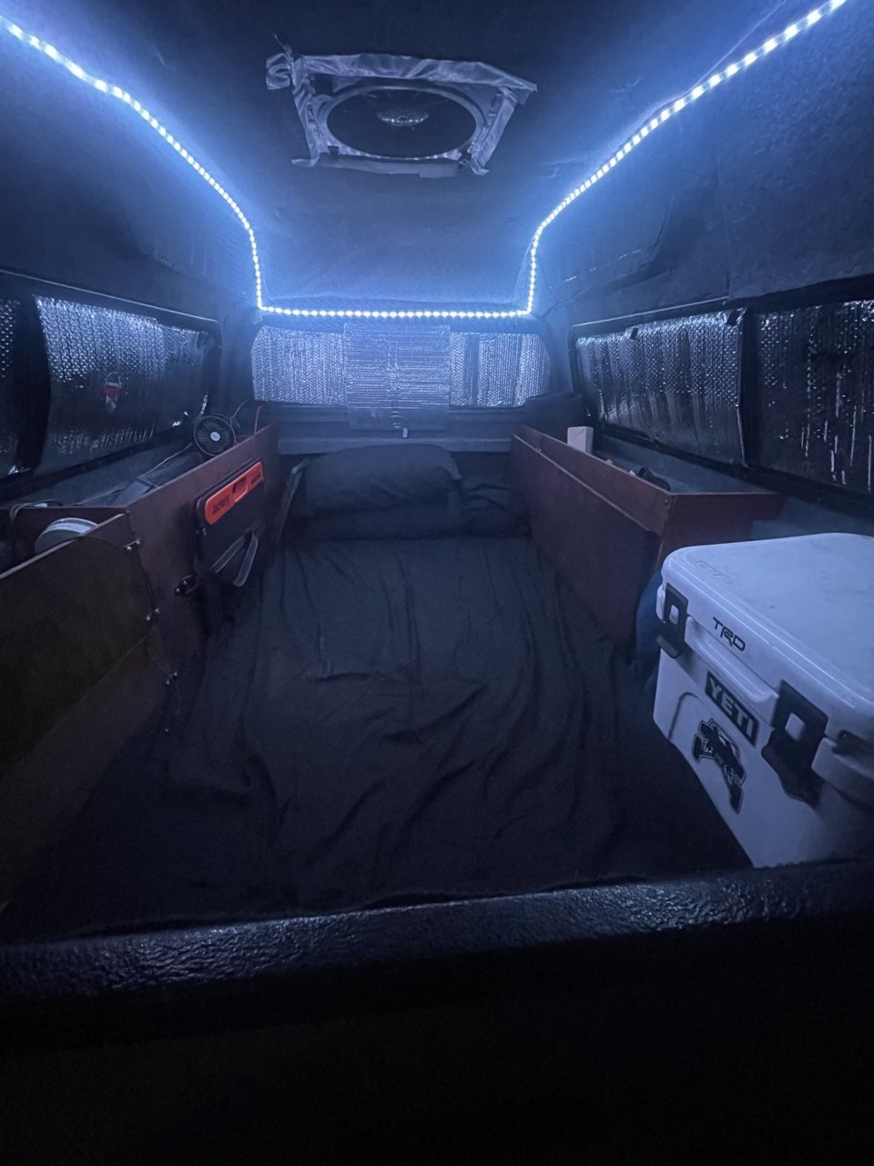

    Update: I still have a lil buddy heater but only use it to preheat the camper and shut it off while awake. I have a electric blanket, hand warmers, and my 0 degree sleeping bag, oh and my shell is now insulated. I also have a co and smoke detector. Got a Jackery since then. I’ll post a pic of my shell.
