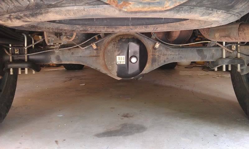

    FINALLY GOT IT! WOOOOT! Brand new shiny fill plug
    I finally found a 15/16 6-point socket. I beat it on the plug with a hammer anda block of wood, and attached my Makita Impact, and it didn't budge. Finally got it loose with a breaker bar. :D IT DIDN'T BEAT ME!
