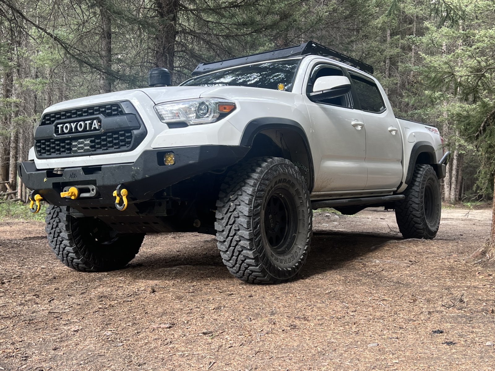

    18 Tacoma TRD off road OME BP51 front Fox 2.0 Resi rear OME Dakar Meduim Yoko G006 325/75r16 Black Rhino stadium wheels Cali raised ditch light brackets Baja Designs S1 pods Baja Designs Squadron SAE fogs Prinsu Cab rack TRD Pro grille AVS rain guards Backwoods adventure mods hi-lite bumper BL Apex 12k winch Dobinsons 4x4 snorkel Sy-clone prefilter ARB rear diff breather relocation RRW rock sliders RCI full skids At the helm bed stiffeners lil b LCA skids Warfab Phantom rear bumper Warfab tie rod sleeves C4 fender liners Dirt king UCA Duro bump stops
    My first lift was a bilstein 5100 and Icon AAL. It worked well and I like how the shocks firmed up the suspension. I thought the truck had to much dive and sway.
    Second lift is a OME BP51 and OME med leafs. At 2.5” of lift. I also have no sway bar so I turned the compression up on my coil overs. Which now has pretty close to the same sway as when I was stock with a sway bar.
    I absolutely would lift again but I also bought the truck with the intention of off roading it.
