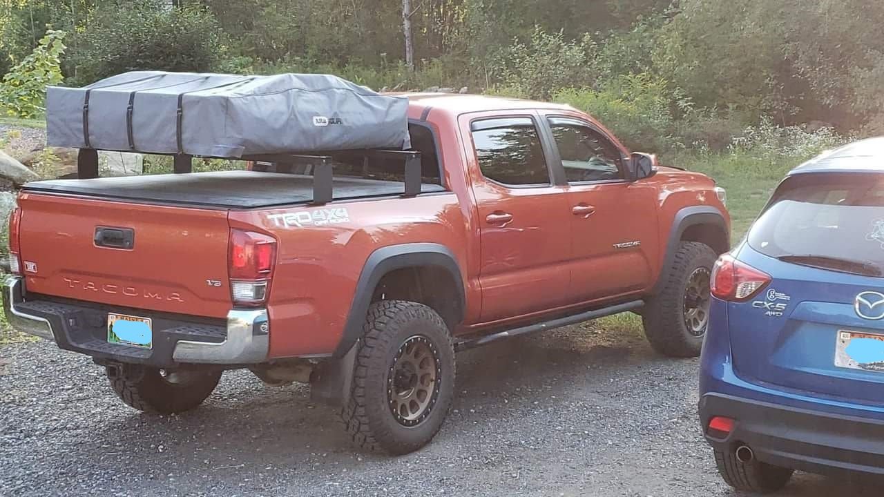

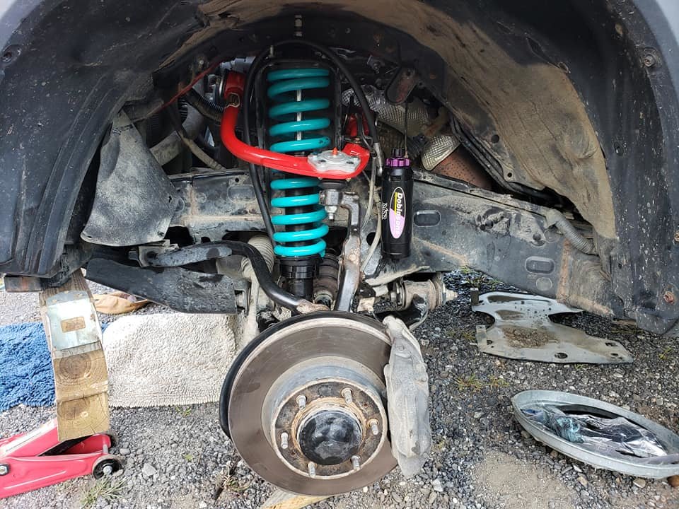

    methodMR305NV, 265/70/17duratracs, ARB RTT, DITCH Lights
    DOBINSON MRA 2.4" LIFT KIT (STOCK REAR SHOCKS with extenders for now, rears showed up on Sept 19th they are now installed as of Sept 27th.
    lift kit with all my camping gear in it (roughly 200lbs of camping/recovery gear, and a 5 gallon Jerry can, my Fuel cans were empty in this pic.. so easily add another 80lbs for the 12 gallons of fuel) SSO Hybrid front bumper with Smitybilt x20 10k winch w/ synthetic line, Mobtown HD bolt on sliders, ARB Simpson III RTT on a custom bracket KBVOODOO high rise bed bar (3" taller)... 265/70/17 on method racing MR305NV 17x8.5 0 offset.
    I can highly recommend against running stock rear shocks with this setup... I blew out the factory rear drivers side shock on one excursion to the NMW, I believe it either overextended, or just compressed too far down and destroyed the seal.. oil everywhere... good thing I had the new MRA's to replace them.... I'll post pics if anyone wishes... I also did the Archive Garage U-bolt flip kit w/ superbumps. and for good measure I have the ECGS bushing done as well.. JBA high Castor UCA's as well...
    this pic is during the lift install...ECGS bushing in, UCA's in, Shock in, resi not mounted yet (mounts forward of UCA) and yes I had the jack there for safety... I also had 2 jackstands under the frame to the right of the picture... other tire was still on..
    Blackbeard83 and 9mmMike like this.
