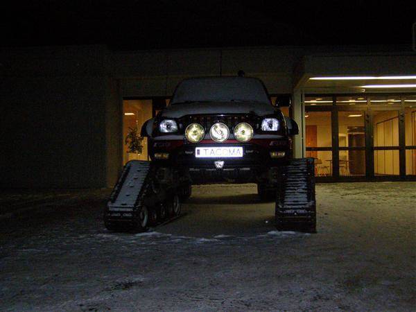

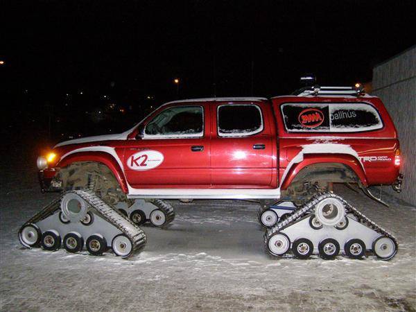

    It has a 4-link system in the back, extra fuel tank it´s 35 gallons and a fulepump so you can fill the orgina tank while driving, it has a 4:88 and a front air lock, it has ranco 9000 shocs in the back and 3" light racing struts in the front, Artick trucks tires 38"x15,5" we had to change the brake system and use brake pumps from landcruser 80 and the brakedisk is built by artick trucks in Iceland ,we did this so we could use 15"x14" wheels for better flote on the snow when you let the air out, It has a lift kit about 2" only on the boddy and then the flairs and running bords,2x air pumps one for the tires and one fore the locker, KN filter, fluricent lights under the car and some lights in the front. inside is the GPS, VHF, CB, and NMT phone and I can´t remember anything else

    Even though the trax look great & probably have the best offroad capabilities. I bet it is badass in the snow & ice! :D
    A few things come to mind. The vehicle with them would have to exclusively be used for offroad/snow. I just don't see someone constantly switching between wheels & trax. I can't imagine what kind of damage it would do to the trax if you used it on pavement. Also that means you would have to trailer it to the offroad area.
    I guess this is for the guy that has more money than he knows what to do with.

    Well, think of all the people that tow ATVs, sleds, rock crawlers, mud trucks, etc to their destination. How would this be any different? No, you wouldn't take it on the highway. If your buddy with the mud bog lives 2 miles down the road are you gonna swap them? Probably not. Or if you live up in Alaska or somewhere like that where there's always snow, ice and permafrost you wouldn't really need to take them off.
    At the cost I don't see you're average Joe buying them and swapping on and off every weekend, but even if he did so what? If I was changing my tires twice a day on the weekends I'd be pretty damn quick with it! :D Have all the tools and process down with lots of practice.
