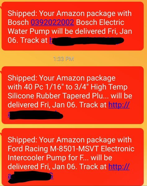

    Thats one i ordered based on the number found on the side of a "toyota part number" picture
    Are you stating for a fact that you have used this part# personally and can vouch for it working?

    That's the same on my TRD kit came with. It's the same as Rousch uses for their kits on Ford. Also, same as I used on an kit(that came in ford boxes?) for the Audi 4.2V8.
