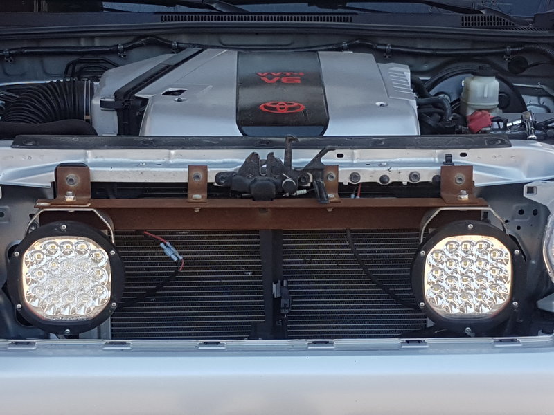

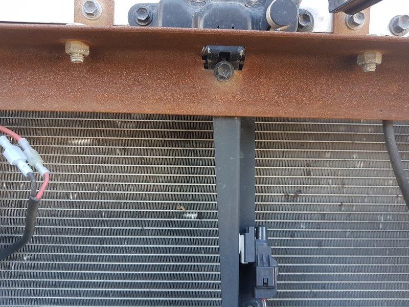

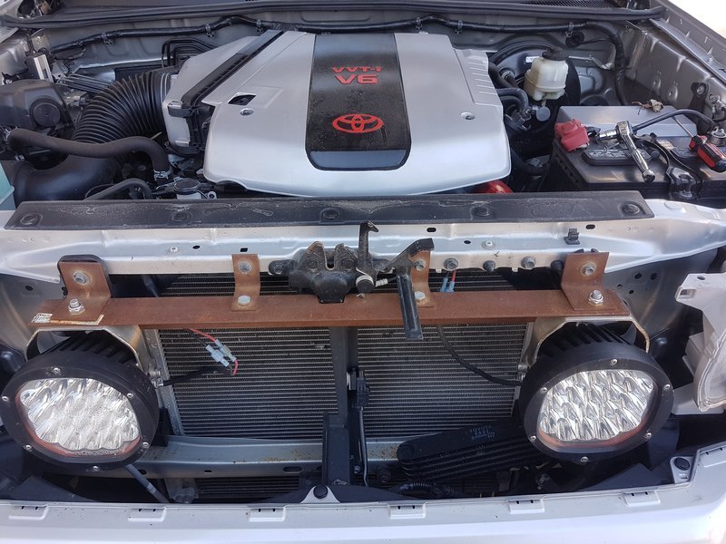

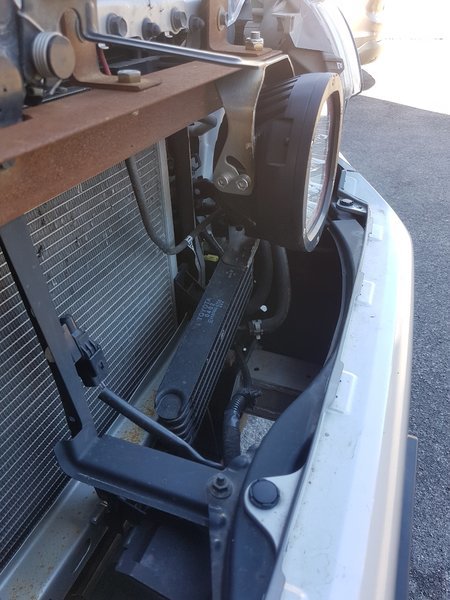

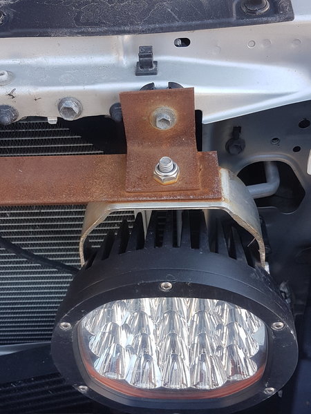

    Well I was able to get you pics.
    Yes I know it is super rusty and ugly....the aluminum one I originally built had to much flex and the lights bounced while driving. I built it out of steel but saved the time of painting to make sure it worked, and haven't gotten back to it....
    I cut off some section of the angle iron to make the brackets. The mounting holes and hardware is all the stock bolts for the radiator support.
    Under the hood release is a 5th bolt I used. I had to go and cut a large notch to allow the cross bar to allow it to slide up on the hood latch, then a bolt under the latch.

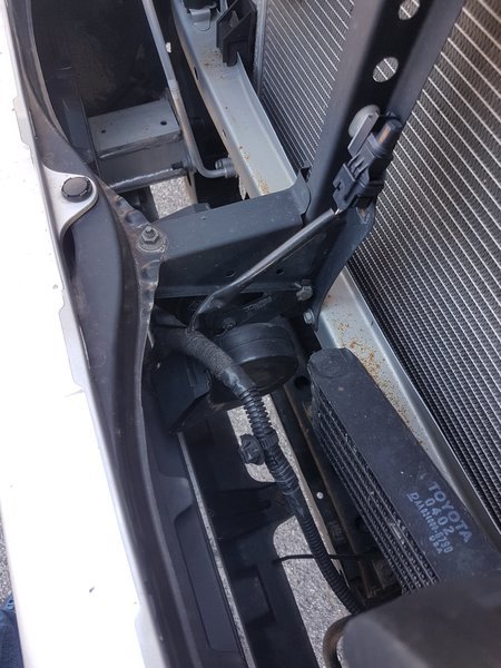

    With the size of your lights you will.most likely need to relocate your transmission cooler and horns. In this pic you cam see how 1 side of the cooler has been lowered.
    You can just see the horns relocation spot in this pic.

    Redo your grill for light pass-through, of course. Gotta move the horns. And I had to move my trans cooler about an inch back.

    Thin ones lile the OP posted. My 7's are deep, probally 5" or so.

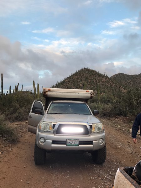

    I used bamf mount with 20" bar. Bright af even behind and honestly not sure if there would be a difference if it wasn't. Looks slick behind there I think

    Nice shot, is that Borrego?
