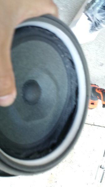

    1) because theyre lighter than a piece of toilet paper
    2)they were made from Cottonelle toilet paper...at least Charming Ultra or something softer
    3) they will magically combust in extreme heat, or chafe the shit out of you whenever the radio plays anther Kanye West's song

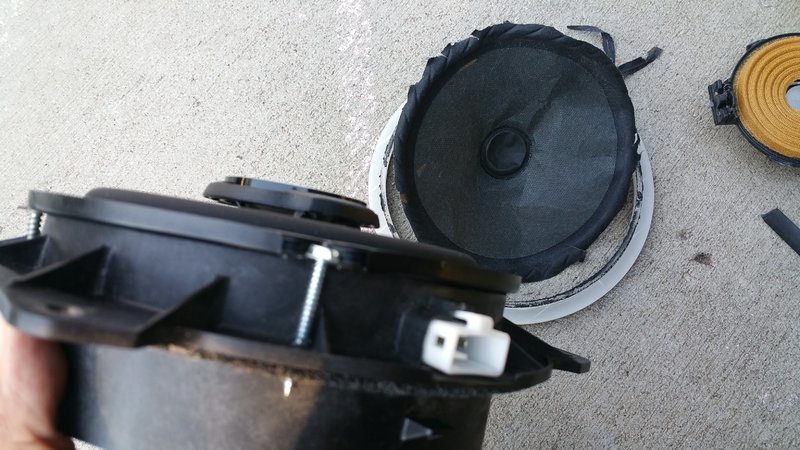

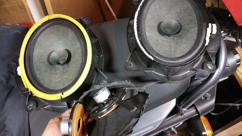

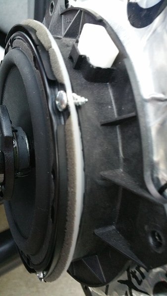

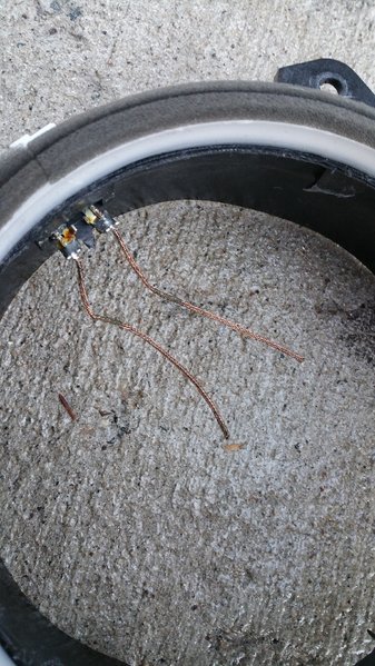

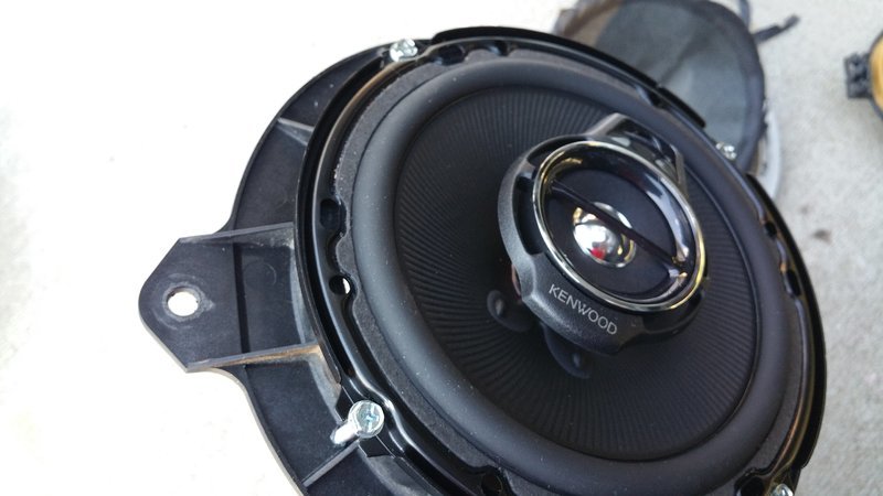

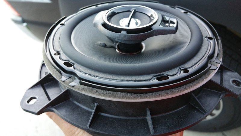

    Seriously though,just tear out the paper from the plastic ring/mount and you can reuse it to mount the new speakers (pioneers in20161001_185919.jpg 20161001_182227.jpg 20161001_182502.jpg 20161001_182637.jpg 20161001_184901.jpg 20161001_174816.jpg 20161001_174819.jpg these pics)

    What speaker brand and model would be a good replacement for going this method using the factory ring from where you ripped out the speaker paper?

    trust me, you won't know how much you're missing until you've replaced them.
    Besides, at $40, how can you go wrong? that's like a night at the movies

    I'd get some mounts vs using the old speakers as mounts. More secure that way.

    stock speakers are such a joke. Driver size is about the size of 5 quarters stacked on top of eachother.... TINY!
    They have adapters for like 10 bucks a pair on Amazon that bolt right up for 6x9s in the front and 6.5in rounds in the rear.
    Best upgrade i ever did was do pioneer 3 way 6x9s and 6.5s in the rear with pioneer tweeters in the top doors.
